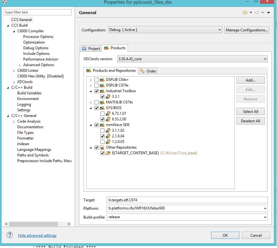

I'm trying to build the people counting demo for the AWR1642 BOOST.
I believe all the tools are installed, but at the end of the build  the  xwr16xx_pplcount_dss.bin and  xwr16xx_pplcount_dss.xe674 are not created,
and I get:
./dss_mmw_linker.cmd", line 40: warning #10068-D: no matching section
"../dss_mmw_linker.cmd", line 55: warning #10068-D: no matching section
warning #10370-D: Possible codesize or performance degradation. Section ".text:RADARDEMO_rangeProc_run:RADARDEMO_rangeProc.oe674" has calls to rts routines, but rts is placed out of range from call site at 0xe00618, or in a different section. To optimize codesize, either 1) place rts closer to call site, or 2) place rts in same section, or 3) compile with --disable_push_pop.
warning #10370-D: Possible codesize or performance degradation. Section ".text:RADARDEMO_rangeProc_run:RADARDEMO_rangeProc.oe674" has calls to rts routines, but rts is placed out of range from call site at 0xe003a0, or in a different section. To optimize codesize, either 1) place rts closer to call site, or 2) place rts in same section, or 3) compile with --disable_push_pop.
warning #10370-D: Possible codesize or performance degradation. Section ".text:SOC_init:libsoc_xwr16xx.ae674<soc.oe674>" has calls to rts routines, but rts is placed out of range from call site at 0x20004e30, or in a different section. To optimize codesize, either 1) place rts closer to call site, or 2) place rts in same section, or 3) compile with --disable_push_pop.
warning #10370-D: Possible codesize or performance degradation. Section ".text:SOC_init:libsoc_xwr16xx.ae674<soc.oe674>" has calls to rts routines, but rts is placed out of range from call site at 0x20004d20, or in a different section. To optimize codesize, either 1) place rts closer to call site, or 2) place rts in same section, or 3) compile with --disable_push_pop.
'Finished building target: "xwr16xx_pplcount_dss.xe674"'
C:/ti/mmwave_sdk_03_01_01_02/packages/scripts/ImageCreator/xwr16xx/out2rprc/out2rprc.exe xwr16xx_pplcount_dss.xe674 xwr16xx_pplcount_dss.bin
makefile:203: recipe for target 'post-build' failed
process_begin: CreateProcess(NULL, C:/ti/mmwave_sdk_03_01_01_02/packages/scripts/ImageCreator/xwr16xx/out2rprc/out2rprc.exe xwr16xx_pplcount_dss.xe674 xwr16xx_pplcount_dss.bin, ...) failed.
make (e=2): The system cannot find the file specified.
gmake[3]: [post-build] Error 2 (ignored)
I wonder what is going wrong.
