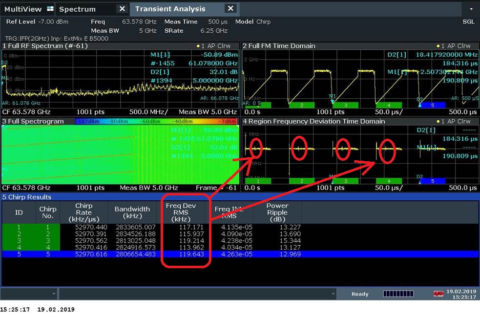

 We tested the IWR6843ISK with the lab0015 people counting. While measuring the chirp frequency by spectrum, we see the frequency will have a spike which causes the frequency deviation about 110k~120kHz (in RMS). Please see below picture of the measurement.
 Is this correct? How can I eliminate this spike?
 PS: we also checked the AWR1843BOOST without seeing the same behavior. This only happens on IWR6843.

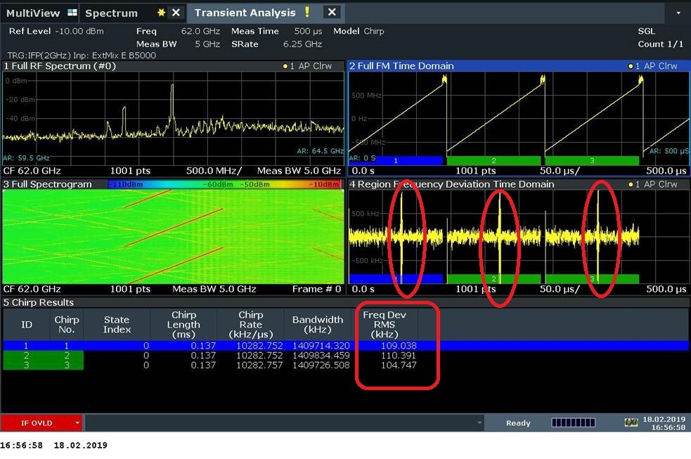

 We also modified the chirp with different start frequency and slope, but still see the same behavior. Please see below 2nd picture.
