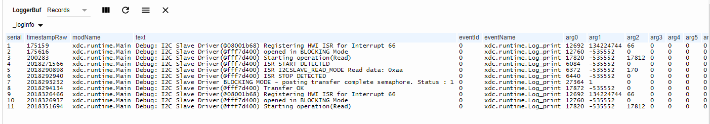

Logs after #define DebugP_LOG_ENABLED  1
Like the log above, the 0xaa of first data is good.
However, the second read interrupt was not generated when MCU sent the second data.

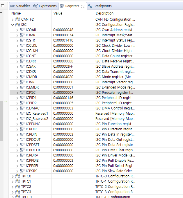

0xBB of the second data is received with the register of ICDRR below, but no interrupt occurred.

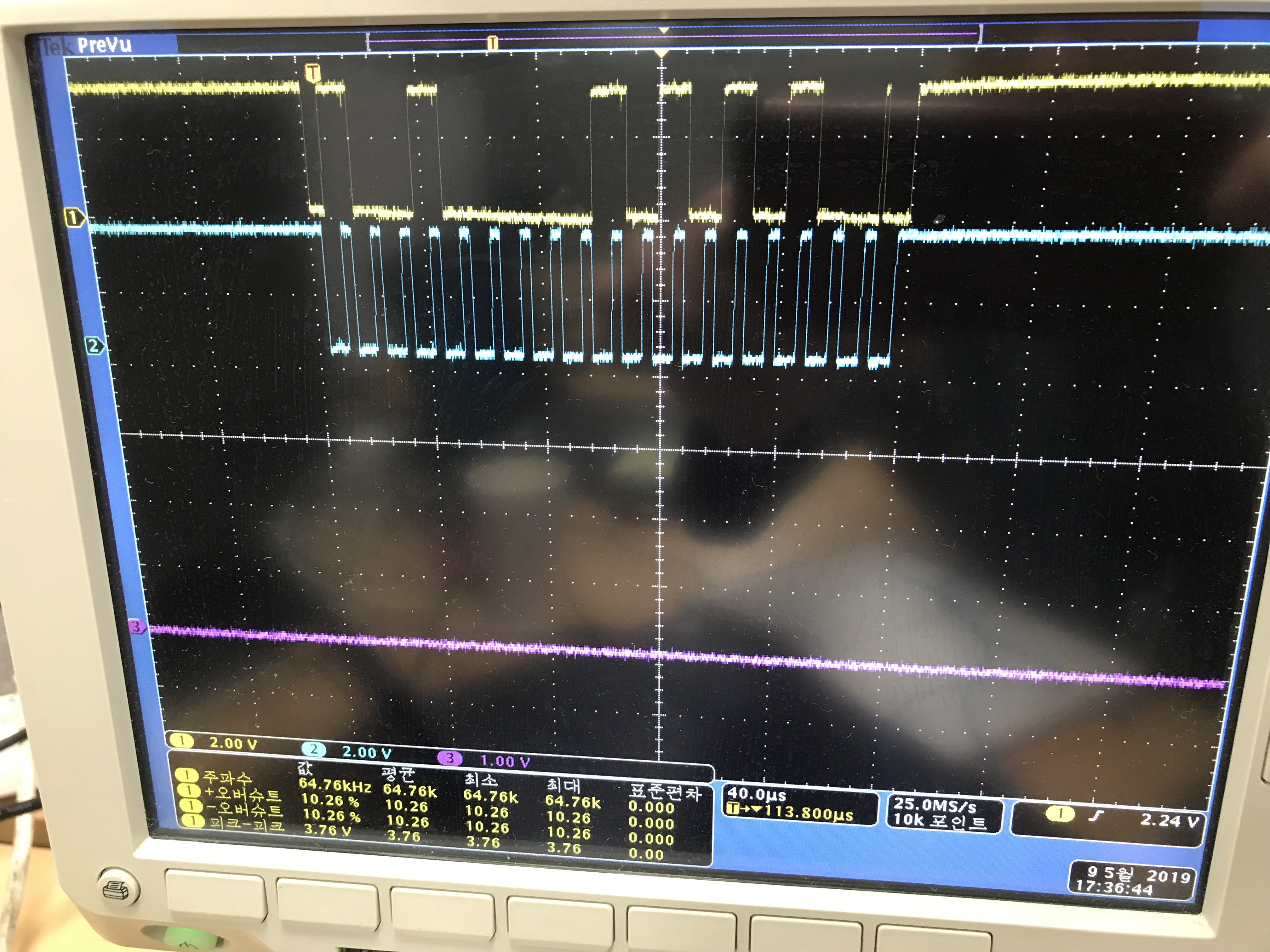

1. First data waveform: normal operation

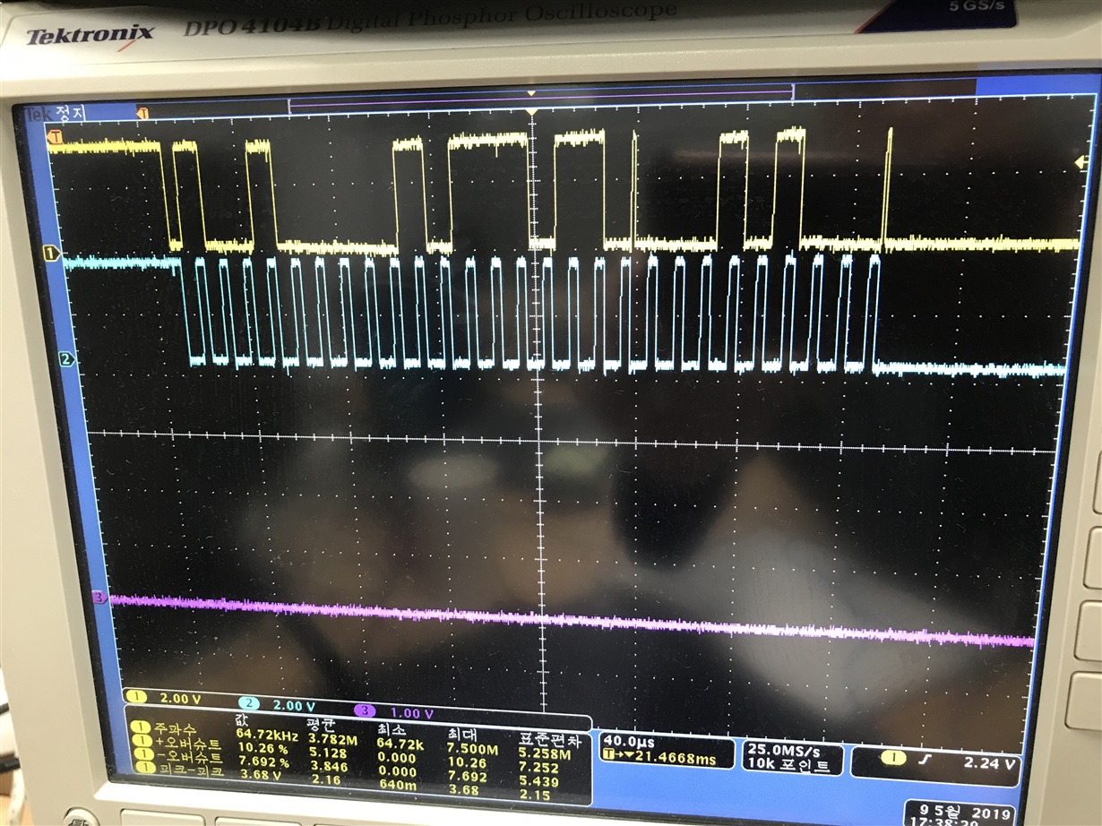

2. Second data waveform: abnormal operation

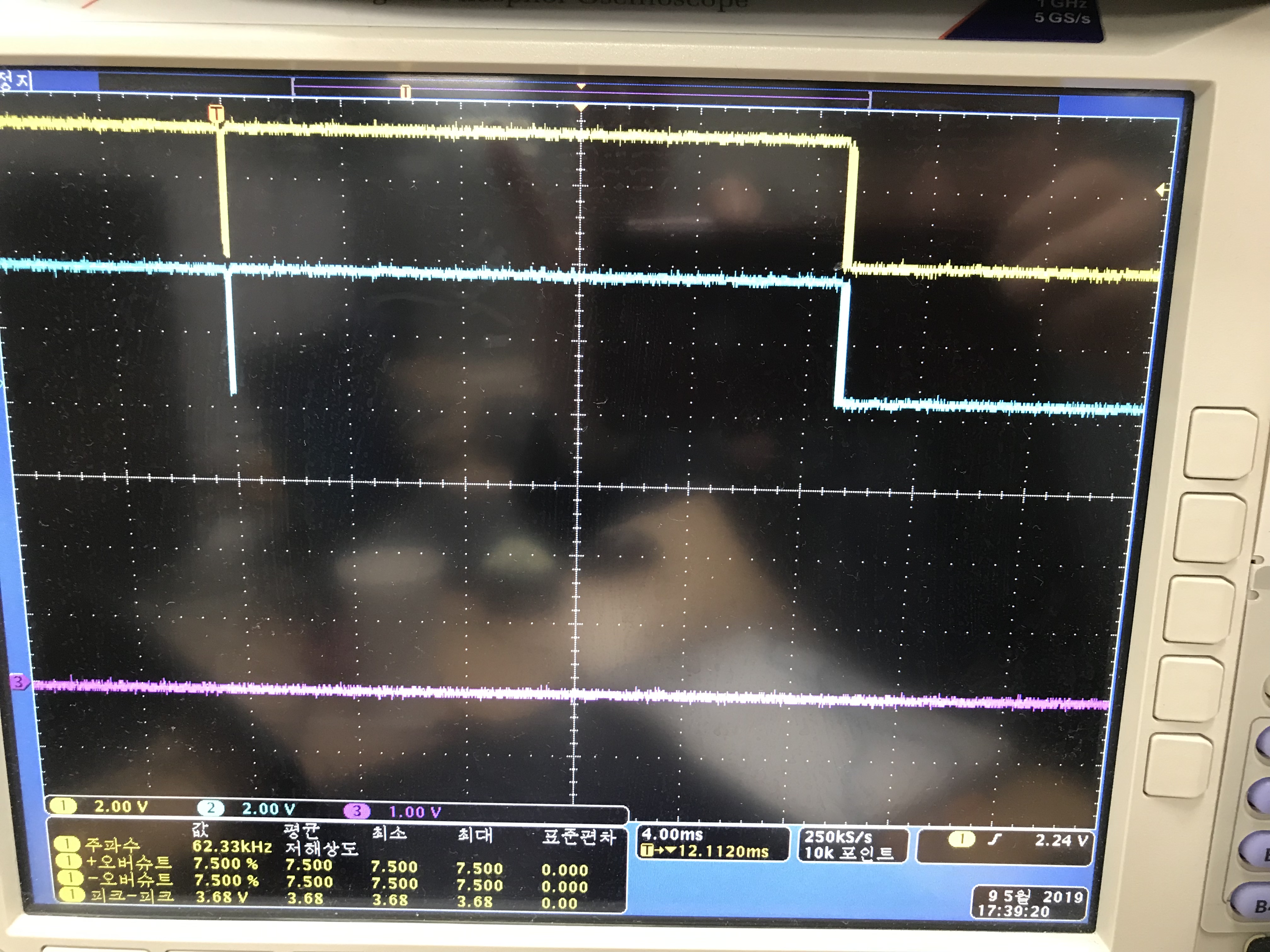

3. Fist Data and Second data waveform (The second data was sent after about 25mS)

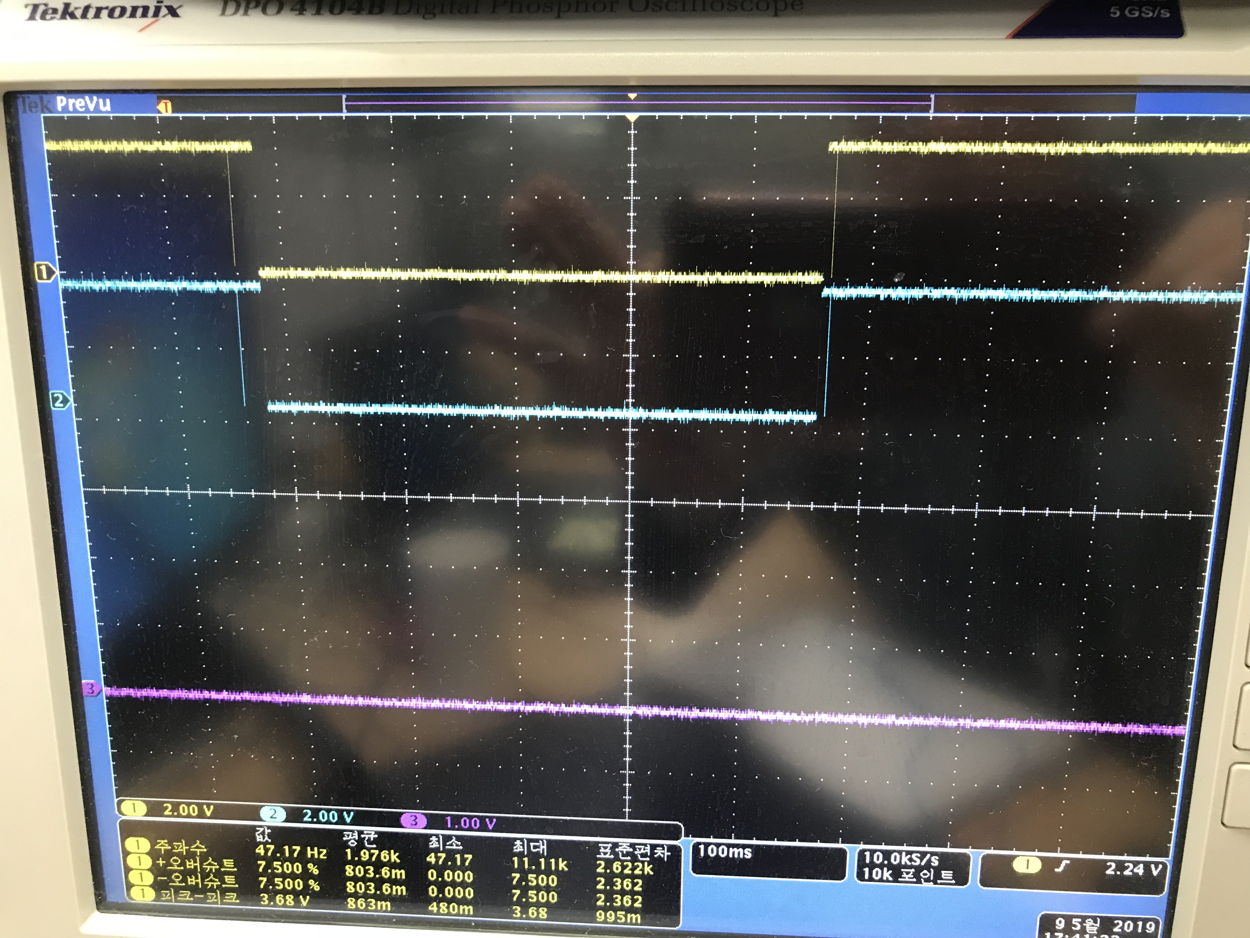

4. Total waveform (After about 600ms, the Busy state is release)

    Also, If the master sends the second data after about 1.5 seconds ~ 2.0 seconds , the second data can be received normally.

    Why do you close the slave in between the 2 reads?
    Just from looking at the logs: the read ready interrupt was not received.
    Do you get a addressed as slave in between the 2 data transfers?
    The receive ready flag(I2C_INT_MASK_RECV_READY) is set only when the addressed as slave interrupt(I2C_IVR_INTCODE_AAS) is a received.
    If we didn’t get a addressed as slave interrupt, the receive ready flag will not be set and hence the receive interrupt(I2C_IVR_INTCODE_RRDY) will not be received.
    As an experiment they can set the I2C_INT_MASK_RECV_READY flag in I2CSlave_setupTransfer() function. Make the highlighted changes.
    if (readWriteFlag == 1)
    I2CIntEnable(ptrHwCfg->ptrI2cBase,
    I2C_INT_MASK_ADRR_SLAVE | I2C_INT_MASK_STOP_CONDITION | I2C_INT_MASK_TRANSMIT_READY | I2C_INT_MASK_NO_ACK);
    else
    I2C_INT_MASK_ADRR_SLAVE | I2C_INT_MASK_STOP_CONDITION | I2C_INT_MASK_RECV_READY | I2C_INT_MASK_NO_ACK);
