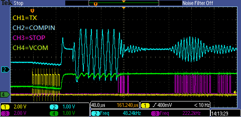

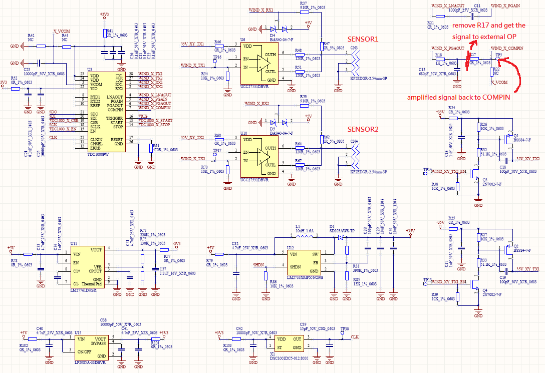

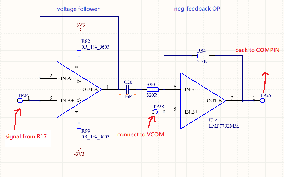

Cause the unsatisfied amplitude observed from compin , so I decided  to use an negative-feedback OPAMP to amplify it.

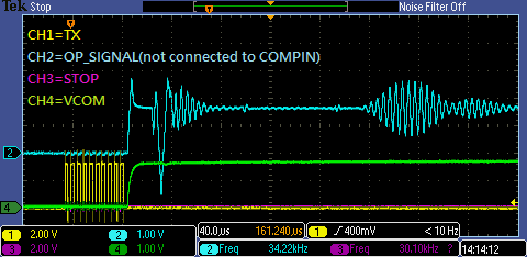

I used the signal on PGAOUT and successfully amplified it. And it 's just seems OK .(this amplified signal haven't connect to compin yet ! )

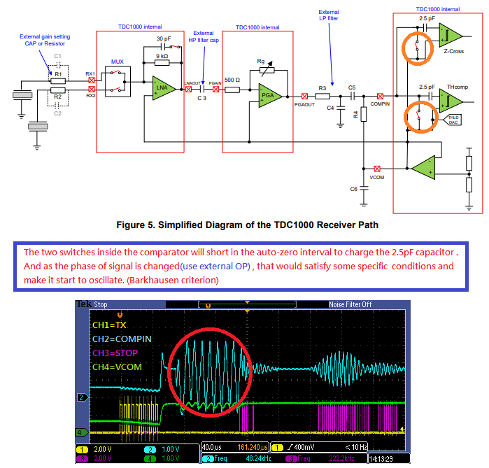

But when I connected it to compin and want to see stop signals after 150us (TRANSMIT+COMMON-MODE+AUTOZERO),
some problems had occurred as the picture below.
What reasons may cause it happen? And how would I do can resolve the weird oscillation ?
