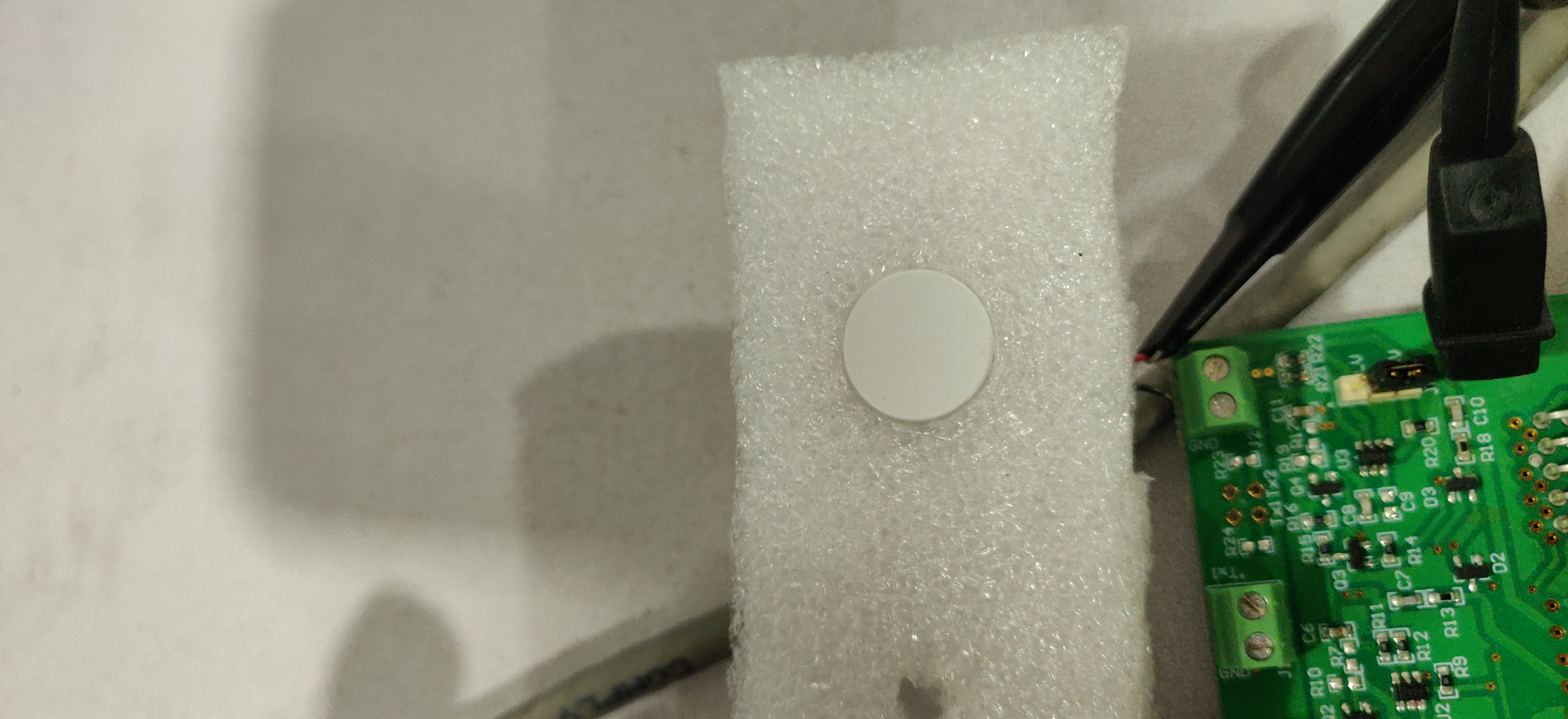

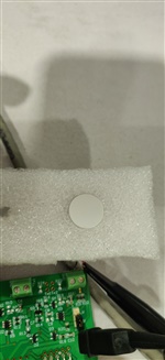

Transducer mounting image:

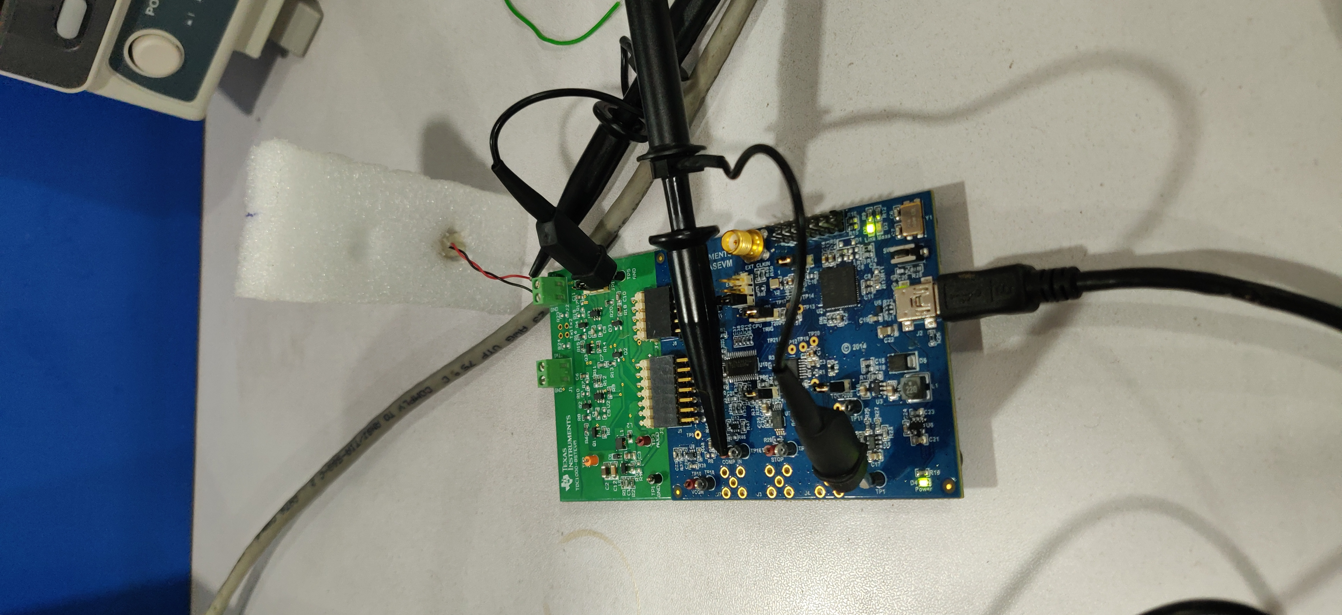

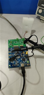

I am trying to measure time of flight by bouncing ultrasonic waves from a wall at a distance of 22cm.  So according to that TOF must be around  1.27ms . The picture for setup is shown below:

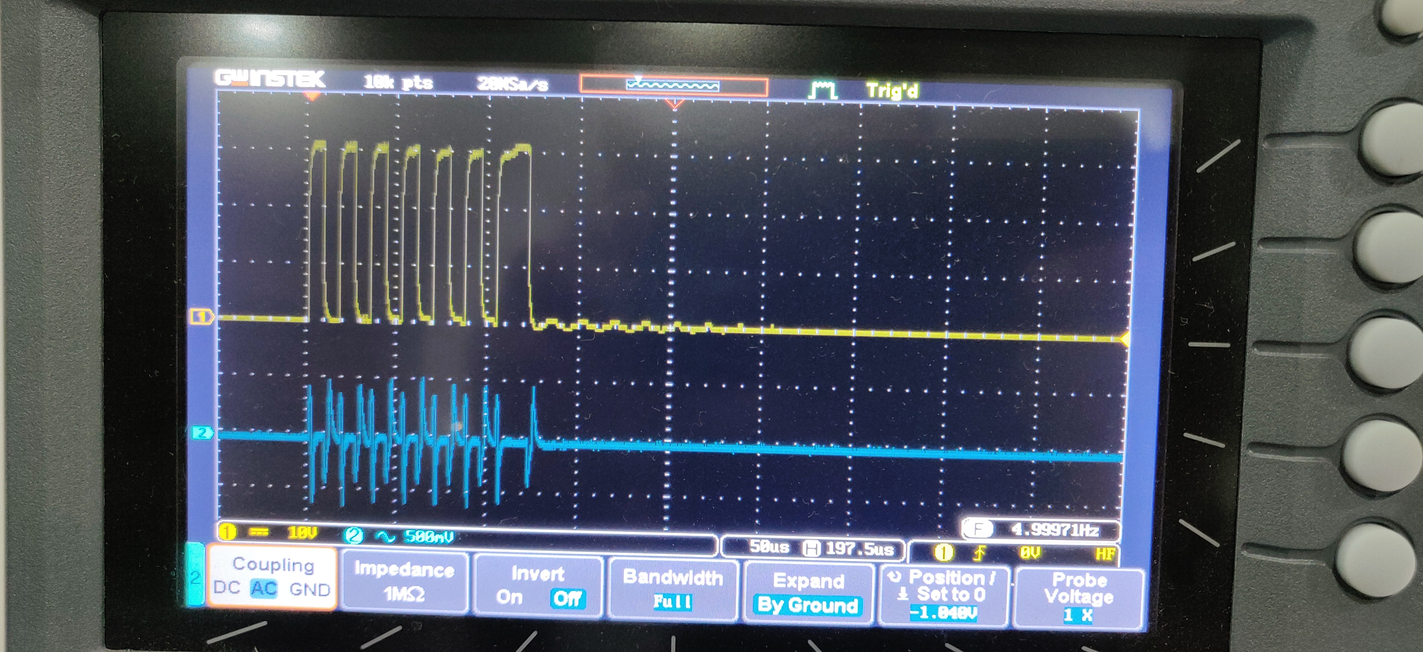

The resonant frequency of transducer is 58 KHz and i am transmitting 7 pulses with same frequency which can be seen in the DSO capture below. I have also captured signal at COMP_IN pin.
Signal on channel 1(Yellow) is Transducer input
Signal on channel 2(Blue)is COMP_IN signal.
When i try to get Time of Flight data on the GUI it is not showing anything. Also it can be seen from the DSO captures that there is no echo. Even if I change the distance of the transducer from the wall still there is no change in the signals observed on DSO. It would be of great help if someone could point out what i am doing wrong or any suggestions for how to measure TOF in air with TDC1000.

    The COMPIN pin signal does not look correct, please try to change the coupling in oscilloscope to DC coupling. Please check the signal at the Tx/Rx end at the transducers itself to check if the transducer itself picking up the echo post its burst.
  • Bharat,
    By using DC coupling on oscilloscope fro COMPIN pin, there is addition of offset only. That's why I have used AC coupling. Regarding signal at TX/RX pin, you can clearly see in the DSO capture above that there is no echo. This is the issue i am facing that there is no echo. If you could go through my configuration file and point out what i might be doing wrong it will be really helpful.

    I see that you do not seem to receive any signal post reflection. Please try to probe an oscilloscope at the transducer end and see you can see it wiggle at transmit & receive.

    My application requirement is to measure distance from 10cm - 30cm. The channel 1 (yellow) signal in DSO capture is at transducer end only. I also read that transducer MA58MF14-7N from Murata can only measure distance above 30cm. Which transducer does TI suggest for use with TDC1000 and distance measurement in range of 10-30 cm.
