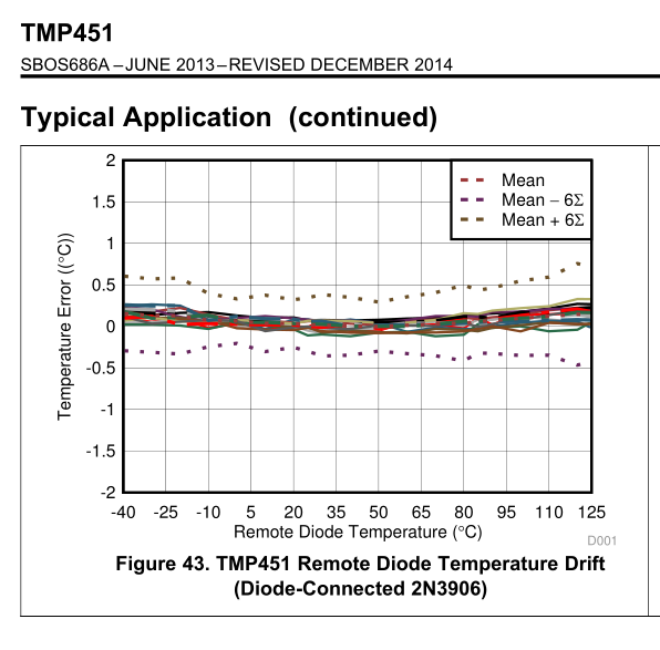

Hi,expert. On the page 32 of TMP451 datasheet,what's the test condition of the picture as below:
16 pcs 2N3906 in an oil-bath with 16 pcs TMP451 in an oil-bath OR 16pcs 2N3906 with 1 pcs TMP451 ?
THX.
THX.
Thanks for you reply.
Another question, when i use TMP451 with 2N3906 in an oil-bath, the local temperature is fixed at 25.0000℃,but the remote temperature is change around 25.0000℃, the reading is 25.0625℃,25.125℃,24.9375℃. Is this normal? why the remote channel cann't fixed at 25.00000℃
