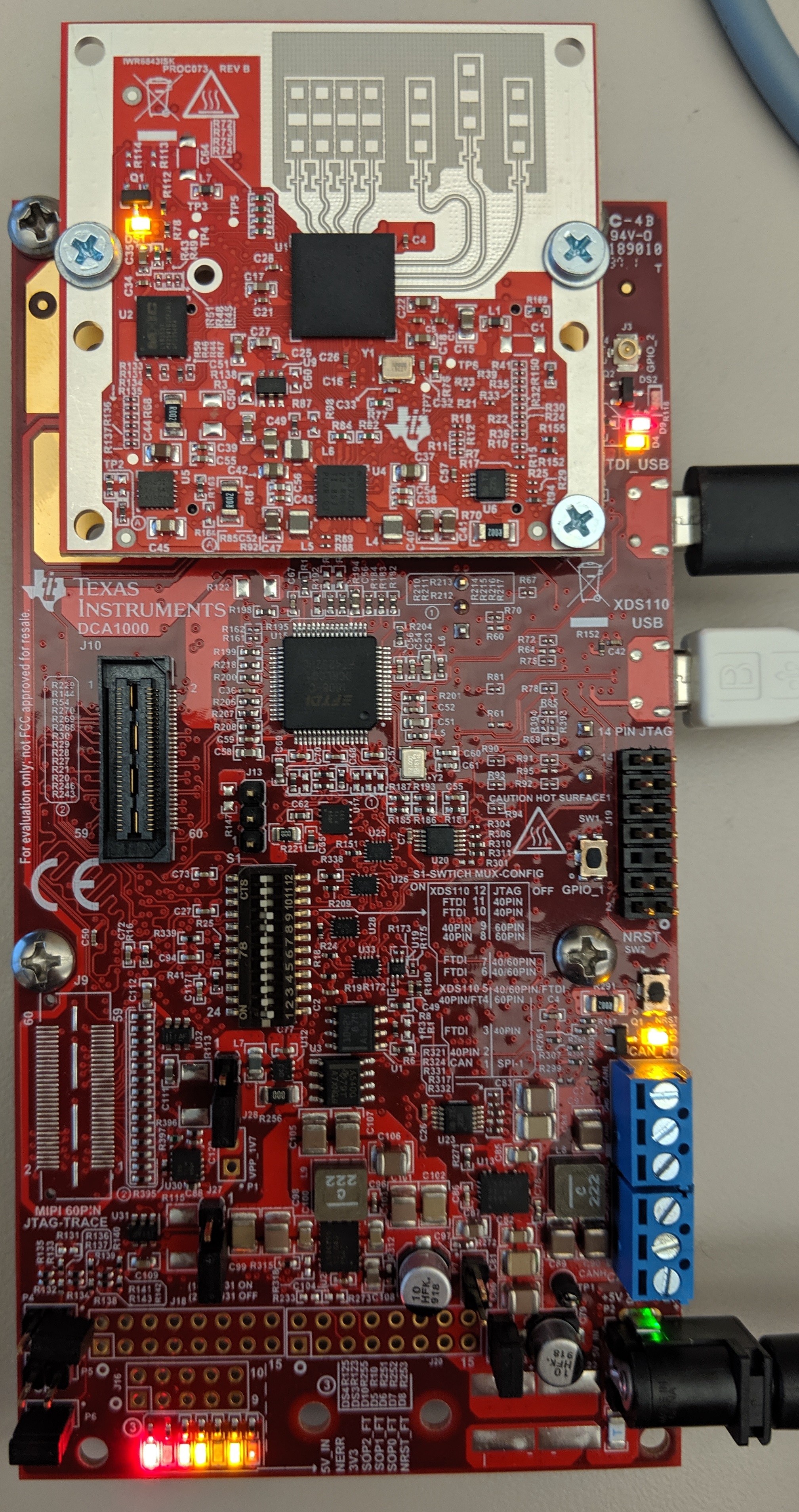

- if the FTDI micro-usb cable is plugged in the SOP indicator lights get much brighter and flash "randomly", eventually staying on and showing different SOP status lights than I would expect
- when connecting to the demo visualizer I've occasionally seen the message "Hardware Connected" rather than "waiting for data ..." and even more occasionally I've seen it say something like "Hardware Connected no security"

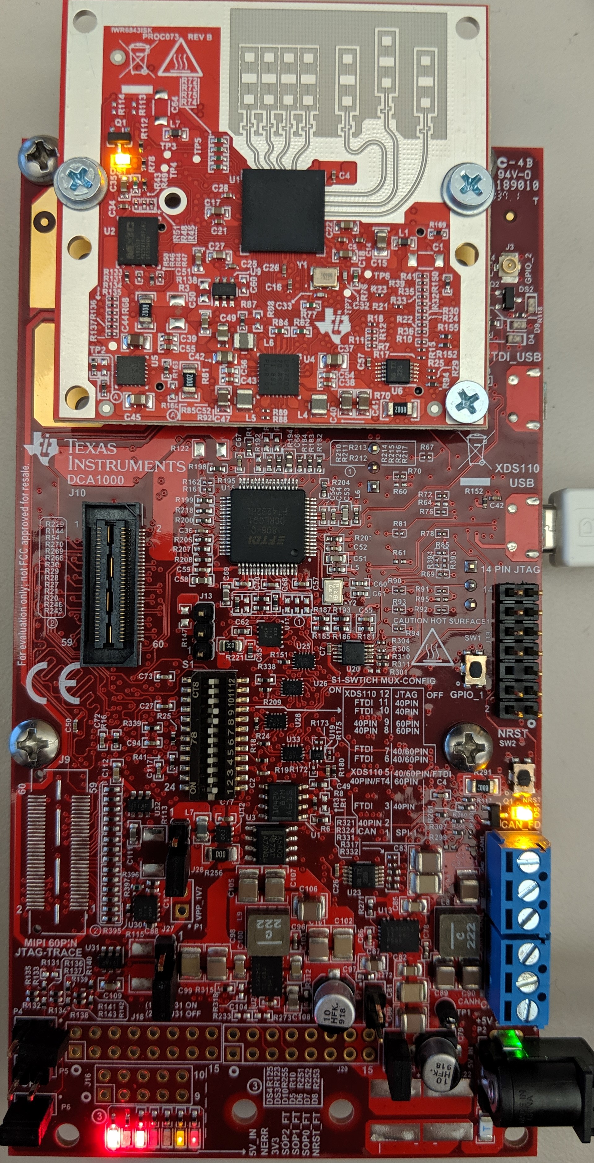

board images
board image with no ftdi cable plugged in
board image with ftdi cable plugged in

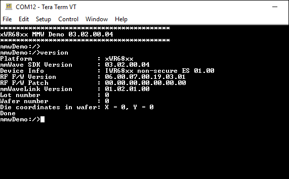

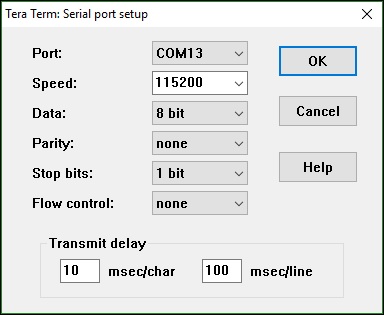

    1. Please re-flash the board with the mmw demo binary provided in the latest MMWAVE-SDK (3.2.0.4)
    2. Instead of connecting the mmWaveDemoVisualizer, please connect a terminal program such as TeraTerm to the Control UART port and see if you get the mmw demo cli prompt. Use the settings shown below.
    3. The initial demo prompt (after pressing the NRST switch) includes SDK version information as shown below. You can also type the "version" command on the CLI to print out the SDK version and other details as shown below:
    -Nitin
  • I tried that and got nothing on the serial port.
    steps:
    - reflash board with 3.2.0.4
    - try opening tera term on both Application/User UART and Aux Data Port (see settings below). nothing appears after reboot/NRST for either.
    - I tried flashing the board again and still got nothing

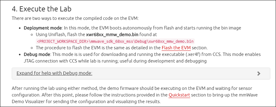

    We need to run the OOB demo in CCS debug mode on this board to understand the failure. Please follow the steps mentioned in section 3.2.2 CCS Development mode of the SDK user guide to run the mmw demo CCS binary in CCS mode and see if you get any error messages on the CCS console.
    NOTE: Before loading and running the CCS bianry, you will need to flash xwr68xx_ccsdebug.bin using Uniflash as mentioned in the above section in the user guide.
    Also, send the snapshot of the function call stack where the program failed.
    -Nitin

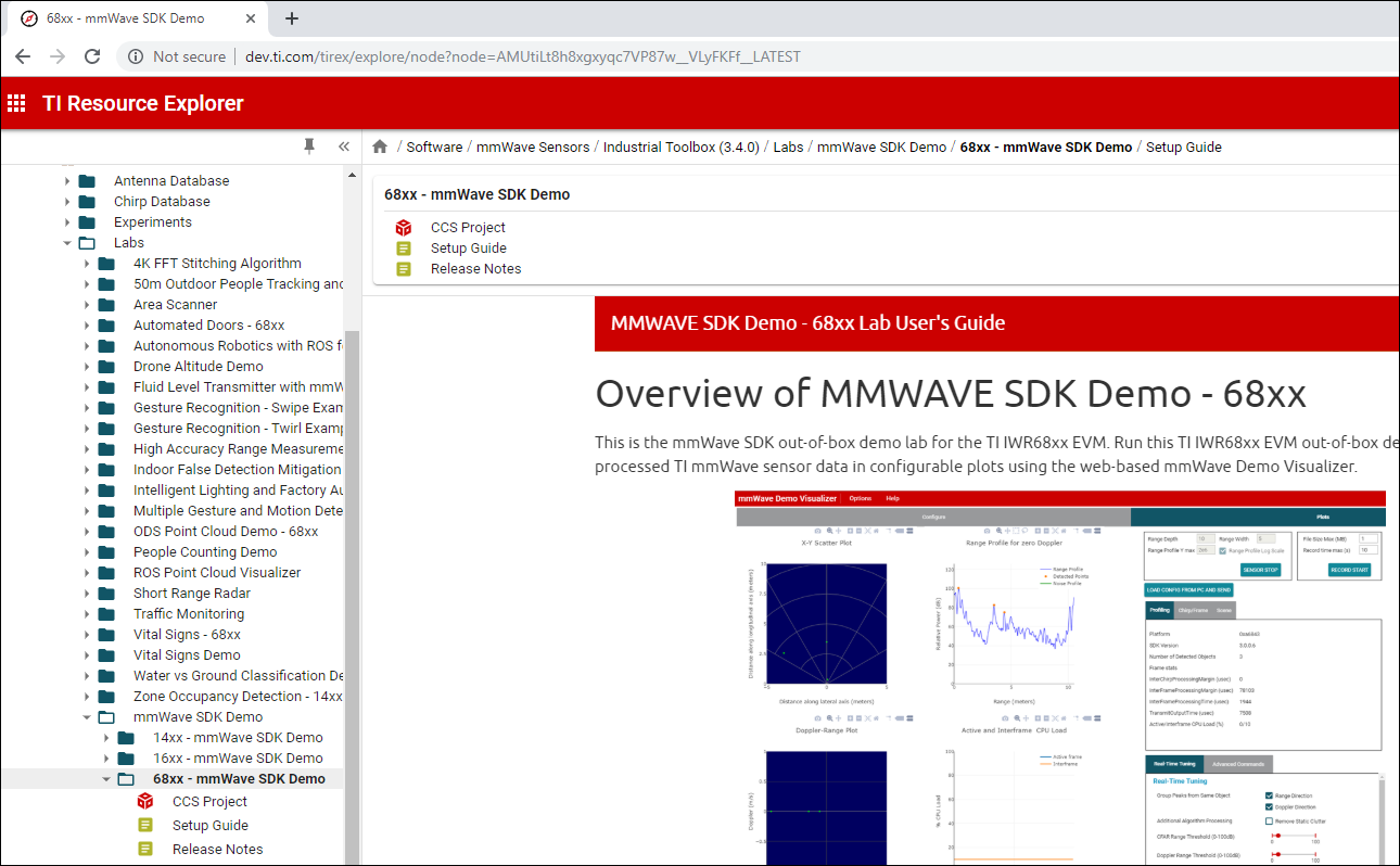

  • Hi Nick,
    The steps to run the demo in CCS debug mode are explained in the mmWave SDK user guide but they are also explained with visual snapshots in the mmWave SDK Demo - 68xx Lab under mmWave Industrial Toolbox on TI Resource Explorer (please use chrome as TI Resource Explorer doesn't work too well with Internet Explorer).
    1. Open the following link in Chrome Browser: http://dev.ti.com/tirex/explore/node?node=AMUtiLt8h8xgxyqc7VP87w__VLyFKFf__LATEST. This will directly take you to the 68xx SDK demo lab as shown below:
    2. Scroll down to the Developer's Guide section and install CCS 8.1 using the link in the Software Requirements table
    3. After installing CCS 8.x, scroll down to section 4. Execute the Lab, and Click on "Expand for help with Debug mode >" helpbox as shown below:
    4. Follow the instructions given in this section to run the precompiled demo firmware (location provided in the instructions) and check the console logs for any error messages.
    -Nitin

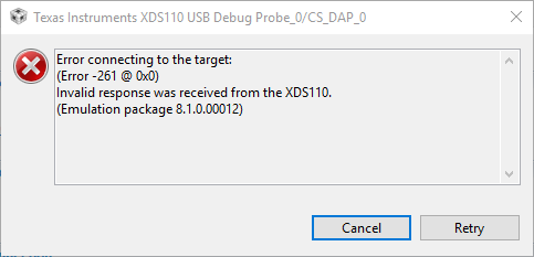

  • Nitin,
    when I make the ccxml file and hit "test connection" it spits out this:

    but when trying to connect to the Cortex_R4 after launching the target configuration it fails every time (see below).
