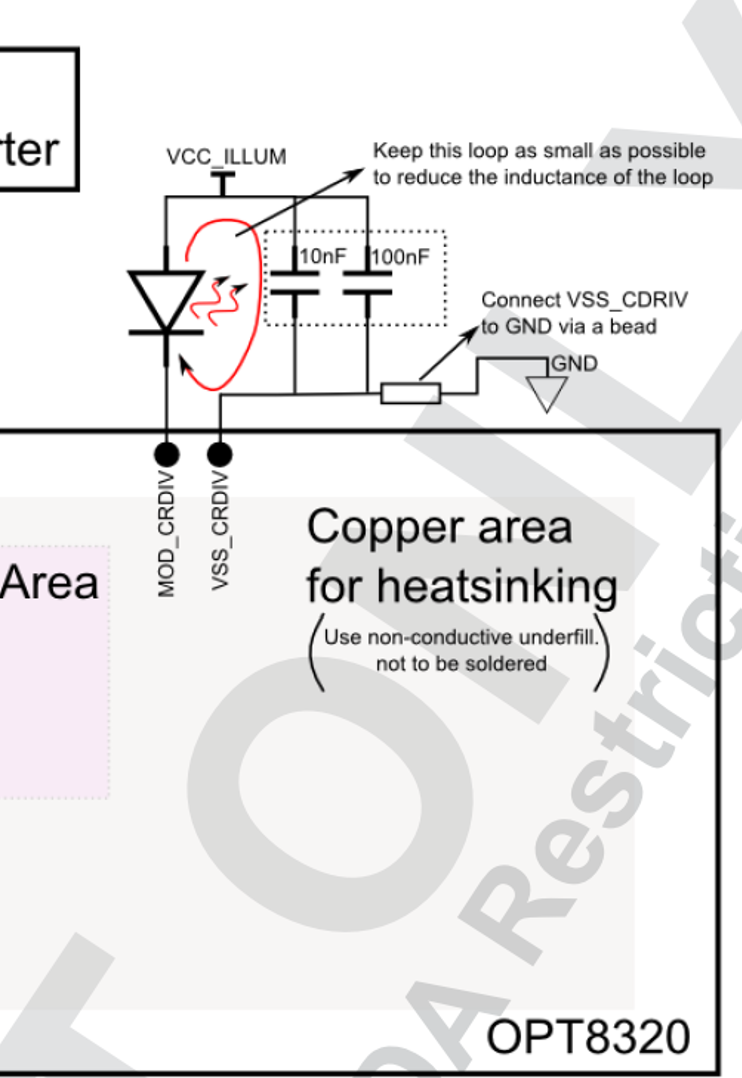

OPT8320: How should the MOD_CRDIV pin of opt8320 be implemented?
Expert 1140 points
Part Number: OPT8320
In our design we haven't implemented an Led in the MOD_CRDIV pin.We found a recommendation in the datasheet of opt8320 for the MOD_CRDIV pin:
Will there be any problem if the pin is not being implemented in the design.Is it having any significance?
