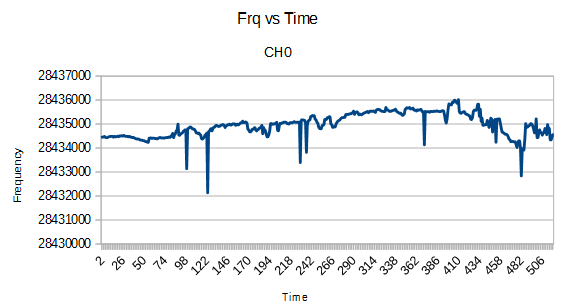

I am using LDC1612 to detect a metal object near to the coil sensor.
In this module will run 24/7 application and i am getting the Digitised Frequency
value by I2C interface, based on the frequency change i am detecting the Metal object present.
At few incidence we observe the frequency captured from LDC1612 has an increasing trend without any target present refer the below image.
In this case we wrongly identify the condition as object detected by sensor and take further actions - which is not expected result.
What wound be the reason and how to resolve this issue?

  • This is probably due to slow moving temperature drift. If you use a reference sensor, you should see the same pattern there. By using a reference coil, you will be able to compensate for the drift.
    The reference sensor should be shielded/have a fixed target so that if you move your normal target the reference sensor does not react.
  • We do have a temperature sensor which we use for measuring temp and compensate sensor value with a constant factor.  This still is not linear change with respect to temperature, so we are not able to determine the drifts for temp change.
    Is there any suggestion to handle the scenario.

  • The best way to do the temperature compensation is to use a reference coil. The oscillator used for the LDC1612 is a major source of drift, so a reference coil can be used to calibrate that out. Using a separate temperature sensor will make it harder to calibrate small shifts.
    Also, are you using an internal or external oscillator for the LDC1612? Using an external oscillator significantly improves the noise and drift performance of the device.
