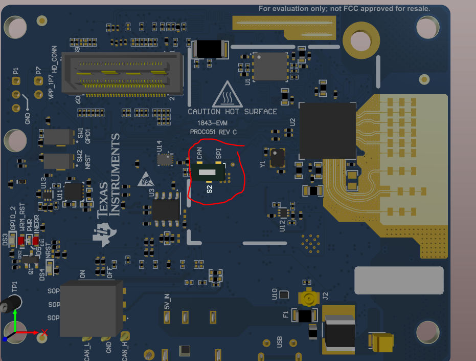

  • Hello Dieter,
    There are two last things we can verify:
    1. You have the SOP settings properly set with SOP0 and SOP1 set to 'ON' and SOP2 set to 'OFF'.
    2. You have set the switch S2 to 'SPI', not to 'CAN'.

  • Can you confirm that you have the SOP switch set to SOP0 = ON, SOP1 = ON, and SOP2 = OFF?
    Also, confirm that switch S2 is set to 'SPI'
    Adrian
  • Adrian,
    this resolved my issue. My switch S2 was not set to SPI.
    Now I get it  SPI To connect, and it is running in mmWaveStudio.
