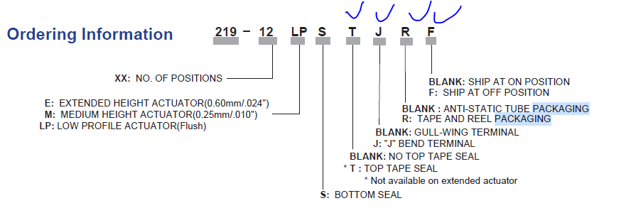

Designator Quantity Value Description PackageReference PartNumber
S1 1   Switch, SPST, Slide, Off-On, 3 Pos, 0.1A, 20V, SMD  6.7x9.09mm 219-3MST
What is the complete Part Number? Follow up with the naming guide, is its lack of 4 number?
The lack of 4 number will define what kind of terminal it used and layout footprint.
Please check it, and look forward to your response.
