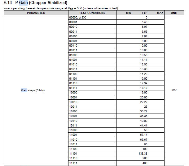

How to understand  PGain  In PGA900.
As TGain , when input of TGain is 0.1mv
,I can read 0.2mv on the register of TADC_DATA1-3  as t select T_GAIN_2_V_V
And I can read 0.5mv on the register of TADC_DATA1-3  as t select T_GAIN_5_V_V.
It  looks like a multiple on the register of TADC_DATA1-3.
But It doesn't look like a multiple on the register of PADC_DATA1-3.
So  how to define PGain.
