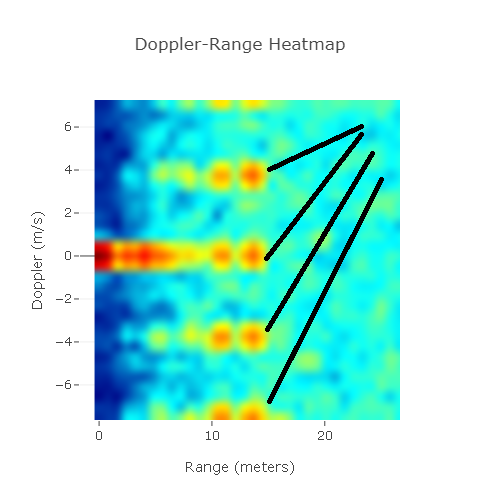

my customer found that AWR1642 have some leakage:
When two transmitters are used simultaneously, we see signal leakage at the output of the data processing system. We found out that this leakage does not come from the antennas, but occurs inside the chip. We would like to understand how you ensure the isolation between the transmitting path and the receiving path inside the microcircuit.
Do you use absorbent materials on the inside of the microcircuit case?
Do you use ferrite on a crystal to increase decoupling?
