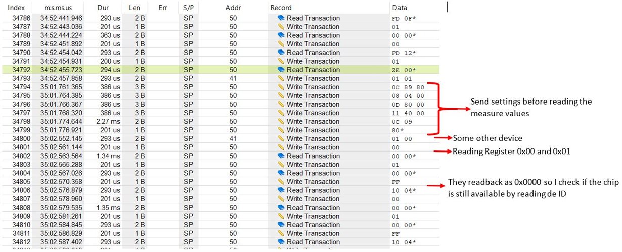

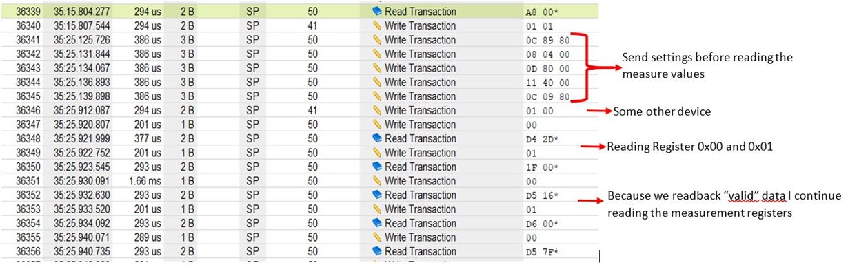

  • I have some log files of the I2C bus. I was not able to connect a scope to the CINx pins. But what information can it give us if would be able to do so?
    Below is a logging of a wrong measurement.
    Below is log of a correct measurement
    To give you an idea of the frequency, this happened after 560 measurements/ level detections. I can run 150 level detections per hour.
    I hope the loggings will help define the issue.

  • With the way you are doing the measurements, probing CINx would not be useful. Originally, I thought you said that this issue occurred even when not reconfiguring the device before a measurement. If that was the case, then monitoring CINx could tell us exactly when the measurement fails, and we could see if there were any issues with the I2C signals immediately beforehand.
    Can you add a step to check that the RST bit in the FDC_CONF (0x0C) register goes back to 0 to ensure that the reset has completed before sending the next I2C write transaction? This would happen immediately after the I2C write of 0C 89 80.
