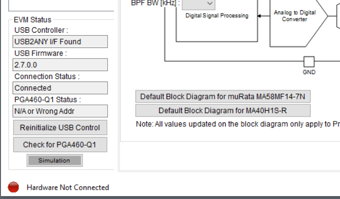

  • Hi Akeem,
    I've been programming my (BOOSTXL-PGA460 + MSP-EXP430F5529LP) bundle with Energia examples (stand alone) as well as PGA460-Q1 EVM program and my board seemed to be bricked. Is there a launch pad tool to wipe MSP board and start from beginning. Thanks
  • Hi Lu,
    Can you elaborate on the LaunchPad error you have encountered, and what sequence of events led up to the error?
    Is your PC still able to detect the MSP430 Application or Debugger COM ports?
    You may need to defer to the MSP430 E2E forum for further guidance on the LaunchPad debug.
  • It just said hardware not connected and I was not able to program it anymore.
    I just need to get measurement data from uart. Is Energia (standalone) best way to do it? Thanks,

  • Lu,
    Your GUI status connection and Energia COM port output messages seem to indicate that the PGA460 is not receiving power, or the UART's TxD and RxD pins are not connected. How are you currently powering the PGA460?
    The GUI shows that the firmware is programmed and properly running on the EVM.

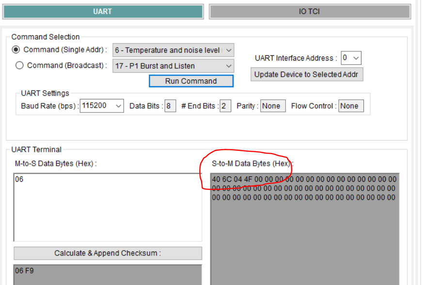

  • Hi Akeem,
     When I run "6-Temp and noise level read" command, I get return "40 6C 04 4F" on S-To-M data bytes.  I'd like to know what does it mean. Thanks,
  • Hi Lu,
    You can refer to Table 3 of the datasheet to decode all response commands from the PGA460.
    Command 6 is described as the "Temperate and noise level result" command, where Byte1 is the temperature value and Byte2 is the noise level value. Keep in mind that command 4 "Temperature and noise-level measurement" must be sent prior to command 6, so that the results from command 6 are up-to-date and valid.
    In your example, a raw temperature value of 0x6C is converted to Celsius by: T_Celsius = (T_Raw - 64) / 1.5
    This equation is in the datasheet. This yields a die temperature of 29 C. For the ambient temperature:
    TAmbient (°C) = TDie - [RθJA × (VPWR × IVPWR_RX_ONLY)]
    where
    • RθJA(°C/W) is the Junction-to-ambient thermal resistance of 96.1°C/W.
    • VPWR (V) is the input voltage.
    • IVPWR_RX_ONLY(mA) is the supply current from VPWR pin during listen only mode of 12mA.
    The raw noise level of 0x04 represent the actual noise level value on an 8-bit scale.
    Both of these measurements are detailed in datahsheet sections:
    • 7.3.11 Temperature Sensor and Temperature Data-Path
    • 7.3.5 System Diagnostics - Noise Level Measurement

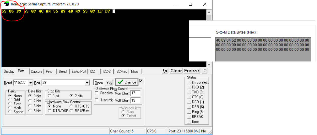

  • Hi Akeem,
     Thank you for explanation. I looked at Table 3 but wasn't clear 0x40 was sync byte for S-to-M data. What I'm not clear is that I'm monitoring PGA460 TX and RX lines with usb to uart and I can see commands going out when I press "06 - temp and noise level read". Please see attached
    0x06 is read temp and noise
    0x4C and 0x4D are registers to read. 0x1F is status register to read.
    However, I do not see  S-to-M response data bytes (temp and noise) in my terminal window. In my example, "40 69 04 52" is what I'm expecting to see as a response from PGA460. I'm only seeing outgoing commands.
    Lu

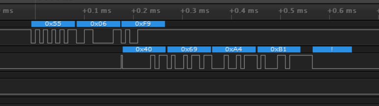

  • Hi Lu,
    To debug your command 6 activity, can you oscilloscope probe the PGA460 RXD and TXD pins to confirm if the device is actually responding? This may be a COM serial port issue.
    You can also try sending 0x{ 55, 06} without the master sent checksum of 0xF9. The master sent checksum is not required for response commands (except register read); only transmit commands need the checksum.
  • Hi Akeem,
     Thank you. I used logic analyzer and I can see PGA460 is responding.
    Lu
  • Hi Lu,
    The device is responding correctly to command 6. The issue appears to be that the RealTerm serial capture software is not able to register the return data because the TXD pin is idle low initially just before the first byte (0x40) response from the PGA460. Try adding a 10kOhm pull-up between TXD and IOREG to ensure the TXD line is always idle high.
