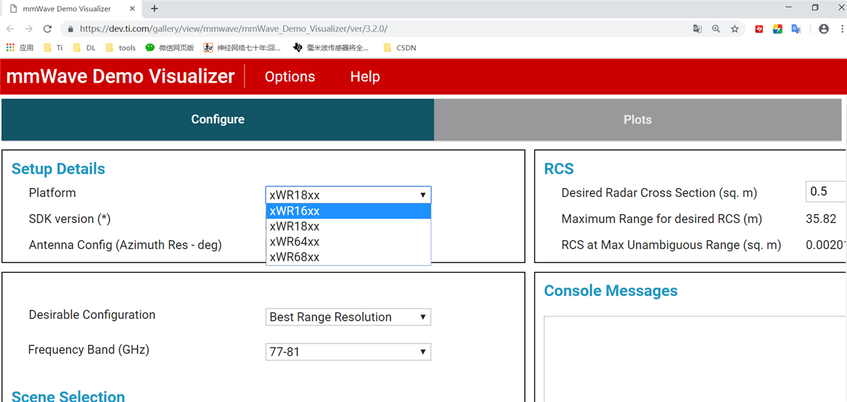

When I opened mmWave_Demo_Visualizer/ver/3.2.0/, there was no option to display xWR 14xx, and no port option appeared when I clicked options.

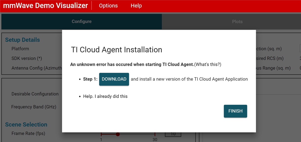

    You need to install TI cloud agent to chrome browser to proceed further. Please click 'Download' button as mentioned in the snapshot.

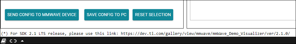

    The latest demo visualizer supports SDK 3.2 and associated devices. IWR1443 is supported by SDK 2.1 and the corresponding demo visualizer.
    Please open mmWaveDemoVisualizer and scroll down on the main page to find the link to the old visualizer which supports SDK 2.1 LTS as shown below.
    Please use only the Chrome browser. You will also need to install the TI Cloud Agent as Jitendra mentioned, when running the visualizer for the first time (follow the visualizer application prompts).
