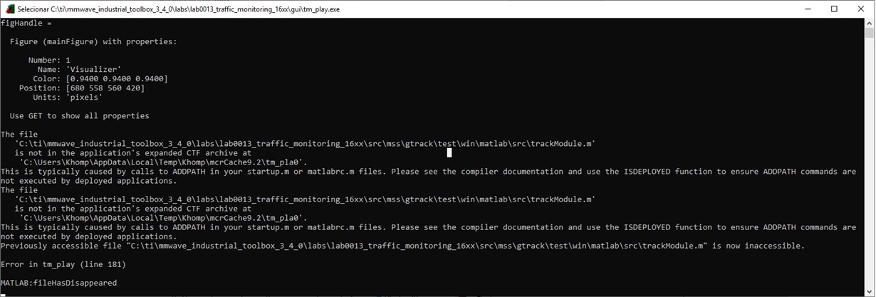

IWR1642: Error running lab13 when tm_play.exe is in PC Replay
Part Number: IWR1642
I'm trying to use the Gtrack Tuning tool that have in the lab13 but was unable to made it run in PC Replay mode.
I followed the tutorial in the: http://dev.ti.com/tirex/content/mmwave_industrial_toolbox_2_4_0/labs/lab0013_traffic_monitoring_16xx/docs/gtrack_tuning_tm.html
I'm getting this message:
Thank you.

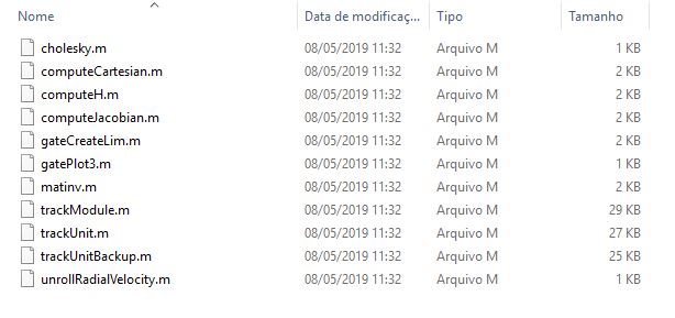

    Please confirm the following:
    1) The industrial toolbox is installed at c:\ti and the trackModule.m file can be located at: C:\ti\mmwave_industrial_toolbox_3_4_0\labs\lab0013_traffic_monitoring_16xx\src\mss\gtrack\test\win\matlab\src
    2) You are following the instructions specified in step 6.

  • Hi Amanda,
    Thanks for the awnser.
    1) Yes, the file is on the right local with the others files:
    2) I did put the Other mandatory parameters as the guide said.

  • Former Member
    0 Former Member in reply to Kevin Guimaraes
    Hello Kevin,
    I've replicated the issue that you are seeing. There must've been some update that is preventing the compiled version from working as previously tested. This will need to be resolved in a future update. For now, the only work around is if you need to compile your own .exe to remove the addpath command and instead package the src files with the executable.
    Amanda
