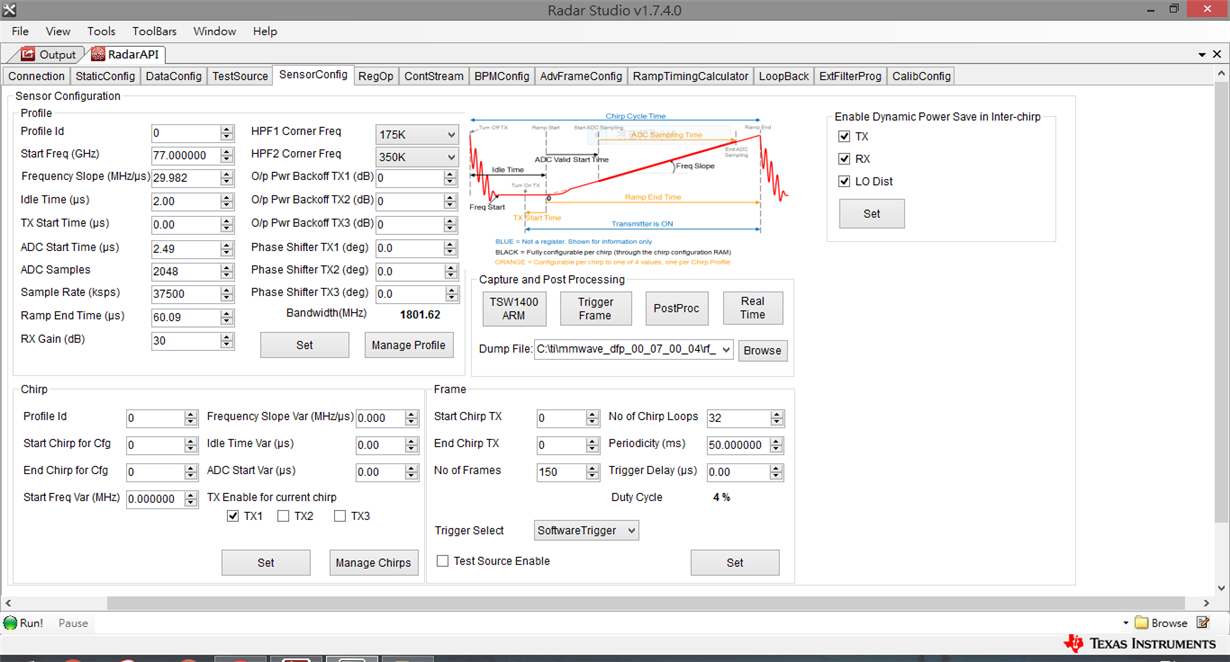

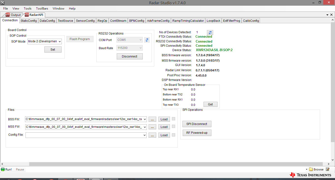

I am trying to capture raw data using AWR1243EVM+mmWave DevePack+TSW1400EVM. I have finished the following tutorial and can capture raw data using the provided configuration.
mmWave Sensor Raw Data Capture Using the TSW1400 Board
However, when I tried to capture another raw data using my own configuration. There is no data collected. I have checked the output shell, but there seems no error happened except it says that No Data was collected.
I guess the problem happened due to the ADC Samples since I can capture raw data if I reduce the ADC Samples to 1024 (Origin is 2048). I know that the maximum ADC Samples is 4096, so I am confused with the problem. Following are about my own configuration and the output shell. Hope someone can help me solve the problem. Thank you in advance.

[17:04:21]  [RadarAPI]: ar1.ProfileConfig(0, 77, 2, 2.49, 60.09, 0, 0, 0, 0, 0, 0, 29.982, 0, 2048, 37500, 0, 0, 30)
[17:04:21]  [RadarAPI]: Status: Passed
[17:04:40]  [RadarAPI]: ar1.ChirpConfig(0, 0, 0, 0, 0, 0, 0, 1, 0, 0)
[17:04:40]  [RadarAPI]: Status: Passed
[17:04:54]  [RadarAPI]: ar1.DisableTestSource(0)
[17:04:54]  [RadarAPI]: Status: Passed
[17:04:54]  [RadarAPI]: ar1.FrameConfig(0, 0, 150, 32, 50, 0, 1)
[17:04:58]  [RadarAPI]: ar1.SetupTSW1400()
[17:05:01]  [RadarAPI]: TSW1400 set-up complete.
[17:05:22]  [RadarAPI]: ar1.StartTsw1400Arm("C:\\ti\\mmwave_dfp_00_07_00_04\\rf_eval\\radarstudio\\PostProc\\adc_data.bin")
[17:05:23]  [RadarAPI]: ar1.StartFrame()
[17:05:23]  [RadarAPI]: Status: Passed
[17:05:23]  [RadarAPI]: Frame trigger async event received!
[17:05:31]  [RadarAPI]: Frame Ended
[17:05:33]  [RadarAPI]: MatlabProc Status: Error Type: No Data was collected. Please check.
[17:05:33]  [RadarAPI]: TSW1400 capture complete
