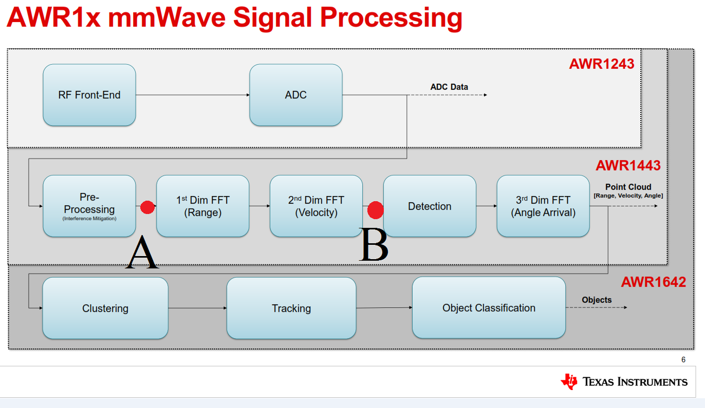

There is an application I want to do using the AWR1642 device. Its signal processing chain is shown in the diagram below.
Somewhere on this forum I saw a thread which said "You can leverage the on-board DSP for developing your algorithms" and some post said "you can also use the on-board memory - though its so small" but i forgot the links where I saw that - but I am pretty sure those two claims are possible.
What I want for my application is to get hold of the data at points A or B as shown in the diagram above, and do my processing or remove some blocks such as clustering. Which file can I use to do that?
    My understanding is that you would like to modify the processing displayed in the block diagrams above.
    First, I think you should be very familiar with the mmWave SDK OOB demo. This processing blocks in the OOB demo are identical to the 2 first raws in the diagram above.

    Thanks Cesar - i understand you.
    I understand the part about the additional capture card but as I was reading through the resource explorer, there are some examples which do not need the capture card - for example, the Medium Range Radar (Lab 0007).
    The diagram I have provided earlier on was simply to provide some context to what I want to do - leverage on-board dsp for processing.
  • Yes, your understanding is correct.
    ALL the demos we have available do not require the DCA1000 card since raw data is not captured on the PC. Only the processed data (also called object data) is sent to the PC through UART. The processing chain implemented on the DSP can be modified as needed.

  • Yes that correct, I intend to modify the processing chain implemented on the DSP.
    Taking the Medium Range Radar lab as an example, there are a lot of .c++ and .m files in the src and gui folders and mapping the processing blocks to the C++ files is proving a bit challenging for me. I couldn't find documentation in the docs folder which explains what each file does.
  • The MRR/USRR lab processing chain uses what we call "subframes". So, it is a more advanced processing chain.
    It may be easier to start with the mmwave SDK OOB demo.
