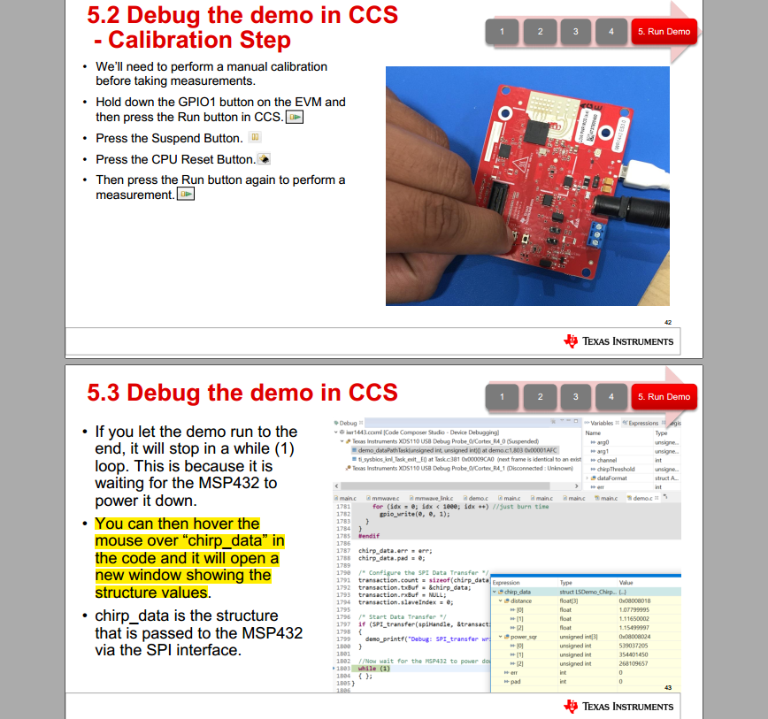

when i to run the demo  and i load the demo to use debugger to debug it i hope i can get some  data by reference a sheet of level_sensing_gsg.pdf ,but it  failure, i can not get anything by the watch window
and the 'err' of value is  -4 and i debug one step by one step ,and get the reason,it because     err = DEMO_MEAS_ERR_CAL;     //not all calibration tasks passed      so i do not know how todo it ,iI would be grateful if someone could help me.

  • i just want to use a board IWR1443 OR awr1443 to run the demo want to get distance/fluid level measurements from IWR1443BOOST board,not use MSP430 EVM,I have not made any modifications when i use the AWR1443 so it failed to get distance by ccs,and i have another problem,that is what different to use IWR1443 and awr1443,I used awr1443 to run the demo but it failed .hope you can reply me,thinks!
  • importantly i download the TIDEP-0091 level senor demo,to the AWR1443boost,so it failed

  • oh ,i just  modification  The first set of instructions are Mandatory,and not modification The second set are highly Recommended ,and then i  comment
    #define PMIC_TYPE_J  //if PMIC on board has not been modded then comment this out.in demo_commn.h file  and debug the demo ,it can not get nothing
