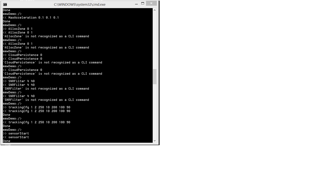

  • Thanks, but I really have a lot of ghosts... that I'm not able to eliminate
    Some more detailed questions:
    SceneryParam -3 3 -3 3.0 0 3 - There are 2 more values, are they z limit values?
    GatingParam 10 3 3 3 0 - There are 5 parameters , what do they represent?
    AllocationParam 50 120 0.01 20 1 15 - the third one is (I suppose it is the radial velocity but in x-y plane or xyz? can I set it to zero?
    VariationParam 0.2887 0.2887 1 1 - I have a lot (really a lot of ghosts), do these parameters affect the ghosting elimination?
    MaxAcceleration 1 1 1 - What these parameters mean?
    AllocZone 0 1 - What these parameters mean?
    CloudPersistence 0 - What these parameters mean?
    SNRFilter 4 40 - What these parameters mean?
    Last question:
    What's the cartesian reference system of the radar, i mean the Z axis is the axis perpendicular to the plane of the radar?
    Alessandro

    My recommendation for reducing ghosts is to increase allocation thresholds.  Ensure the gating parameters are large enough to associate all points near a target with that target.
    Justin
  • Thanks for the reply!
    Now understood I've a few problems with the config file, in particular with AllocZone 0 1; CloudPersistence 0; SNRFilter 4 40 parameters.
    It seems that it doesn't recognize them.
    In this way I can not adjust the SNRFilter and I have a lot of ghosts.
    I attach the output.
