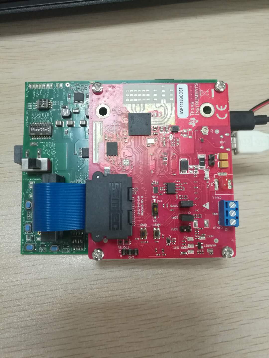

IWR1443BOOST: mmWaveStudio, about the question at "SPI CONNECT"
Part Number: IWR1443BOOST
Other Parts Discussed in Thread: DCA1000EVM,
Dear Mr. or Mrs.
Thanks for your supports,
We run the mmWaveStudio, When click  "SPI CONNECT", will report "Status: Failed, Error Type: RESP TIMEOUT";
the detail log is below, could you please help us about this question? thanks.

[20:54:32] [RadarAPI]: Starting Matlab Engine..
[20:54:35] [RadarAPI]: Matlab Engine Started!
[20:54:37] [RadarAPI]: ar1.LoadSettings('C:\Users\zg\AppData\Roaming\RSTD\ar1gui.ini')
[20:54:38] TESTING = false
[20:54:38]
[20:54:38] ***Script completed successfully.***
[20:54:43] [RadarAPI]: Opening Gpio Control Port()
[20:54:43] [RadarAPI]: Status: Passed
[20:54:44] [RadarAPI]: Opening Board Control Port()
[20:54:44] [RadarAPI]: Status: Passed
[20:54:45] [RadarAPI]: ar1.FullReset()
[20:54:45] [RadarAPI]: Status: Passed
[20:54:46] [RadarAPI]: Closing Board Control Port()
[20:54:46] [RadarAPI]: Status: Passed
[20:54:46] [RadarAPI]: Closing Gpio Control Port()
[20:54:46] [RadarAPI]: ar1.SOPControl(2)
[20:54:47] [RadarAPI]: ar1.Connect(23,115200,1000)
[20:54:48] [RadarAPI]: ar1.Calling_IsConnected()
[20:54:49] [RadarAPI]: ar1.SelectChipVersion("AR1243")
[20:54:49] [RadarAPI]: Status: Passed
[20:54:49] [RadarAPI]: RS232 is not connected ..!!!!
[20:54:49] [RadarAPI]: ar1.frequencyBandSelection("77G")
[20:54:49] [RadarAPI]: ar1.SelectChipVersion("XWR1443")
[20:54:49] Device Status : XWR1443/QM/SOP:2/ES:3
[20:54:50] [RadarAPI]: ar1.SelectChipVersion("AR1243")
[20:54:50] [RadarAPI]: Status: Passed
[20:54:50] [RadarAPI]: ar1.SelectChipVersion("XWR1443")
[20:54:50] Device Status : XWR1443/QM/SOP:2/ES:3
[20:54:50] [RadarAPI]: ar1.SaveSettings('C:\Users\zg\AppData\Roaming\RSTD\ar1gui.ini')
[20:54:57] [RadarAPI]: ar1.DownloadBSSFw("C:\\ti\\mmwave_studio_02_00_00_02\\rf_eval_firmware\\radarss\\xwr12xx_xwr14xx_radarss.bin")
[20:54:57] [RadarAPI]: Downloading BSS Patch RPRC Binary..
[20:55:04] [RadarAPI]: ar1.GetBSSFwVersion()
[20:55:04] [RadarAPI]: BSSFwVersion:(02.00.00.01 (05/10/17))
[20:55:05] [RadarAPI]: ar1.GetBSSPatchFwVersion()
[20:55:05] [RadarAPI]: BSSPatchFwVersion:(01.02.00.03 (24/10/18))
[20:55:06] [RadarAPI]: ar1.DownloadMSSFw("C:\\ti\\mmwave_studio_02_00_00_02\\rf_eval_firmware\\masterss\\xwr12xx_xwr14xx_masterss.bin")
[20:55:07] [RadarAPI]: Downloading MSS RPRC Binary..
[20:55:29] [RadarAPI]: ar1.PowerOn(0, 1000, 0, 0)
[20:55:29] Status: Failed, Error Type: RESP TIMEOUT
