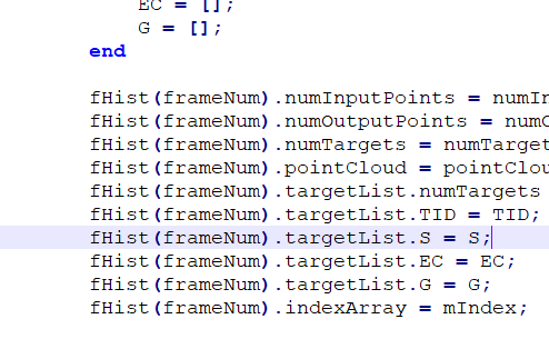

For a project I need to receive the tracking error covariance matrix from the people counting demo (lab0011_pplcount). In the matlab processing file main_pplcount_viz.m I see that the tracking error covariance matrix is defined as "EC". However, in the matlab file that is generated after running the demo, fhistRT.mat, I cannot find this variable EC.
How can I receive the tracking error covariance matrix "EC" from the demo?
