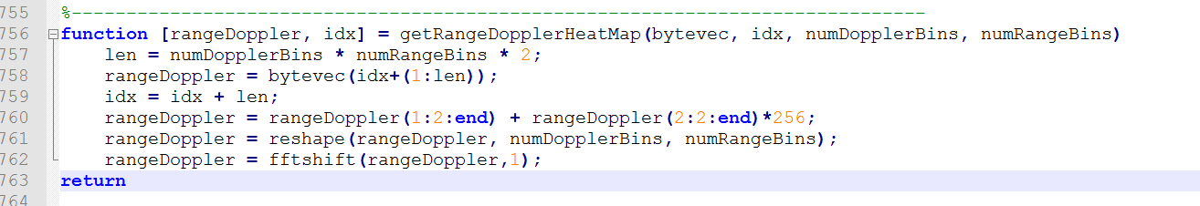

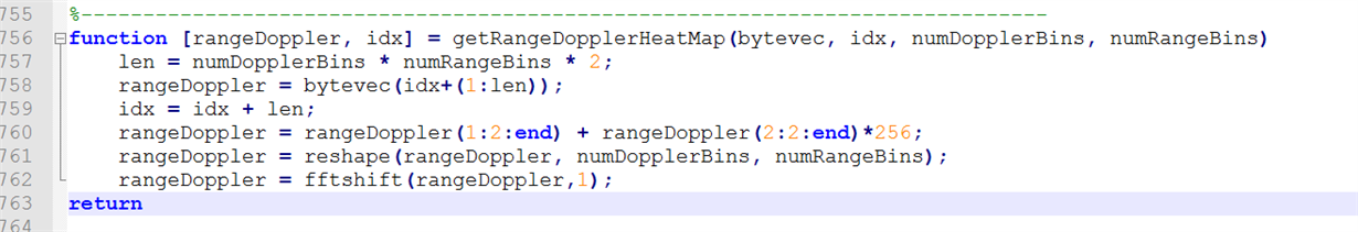

So i see the vehicle occupancy detection GUI code has code to plot the Range_Doppler  heatmap, but:
  1. How do you actually enable the plotting of the range_Doppler heat map?
  2. How you plot the range_Doppler heatmap using the saved data?
  • Hi
    The vehicle occupancy processing chain does not compute a range doppler heat map. It computes a range angle heatmap.
    So probably the Naming in the gui is not correct or it was left over from a different project and is not active.
    Thank you
