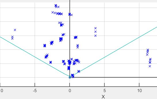

I'm currently working with the Area Scanner Project with my own visualizer and I have some issues. I hope you could help me to understand those:
  • When plotting data from mmWave sensors I always have some "ghost points" which are out of the FoV of the sensor (see image below). Blue lines are limits of sensor FoV a d "ghost points" are around 11m along X axis.
Where those points can come from ? Do I have to remove them "manually" with a "if" in my visualizer ?
  • When testing the project I can't see objects further than 10 meters. Does this limit come from the config (profilCfg or cfarFovCfg) or does a limit is hardwritten in area scanner project ?
Here is my config :

    Hello Quentin,
    There are several parts that can limit the max range of detected points reported by the sensor.
    -profileCfg determines the chirp profile which by physics will determine the max unambiguous range of detectable objects. In the case of the example cfg you provided this is about 9.65m
    -cfarFovCfg is a command introduced in SDK 3.x which prunes the point cloud according to the range and doppler limits provided. In the case of the example cfg you provided this is set to 0.25-60m. Note that the max range of the chirp is lower than the upper limit so it practically doesn't apply. However if your chirp was configured to a max range of 100m then objects detected by CFAR beyond 60m would not be reported by the device.
    Additionally if you are comparing to the area scanner visualizer the visualizer only plots objects that are within the range limits set by the XYZ axes limits.

  • Hello Amanda !
    Thanks for your answer, my profileCfg is the issue so ! I modified cfarFovCfg intentionnaly and I use a visualizer I created.
    I'll generate new profileCfg with mmWave Demo so. Can I simply replace my profileCfg by an other one from a long range config (from an other Lab for example) ?
