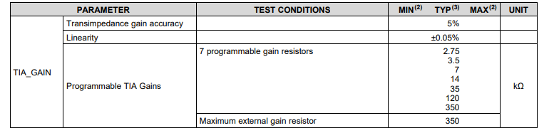

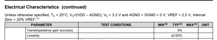

    As far as datasheet specs the only reference I see to your measurement is that there is a 5% transimpedance gain accuracy and a voltage offset that varies depending on the bias voltage.
    Jalen

    I would hope the gain number would be for the internal resistors,  not the external.  Any chance you can confirm my measurements on one of you own eval boards.  And more importantly, why would the gain change with the bias setting?
    We have a requirement to calibrate out as much of the errors as possible.  But I have no idea where these error are coming from.

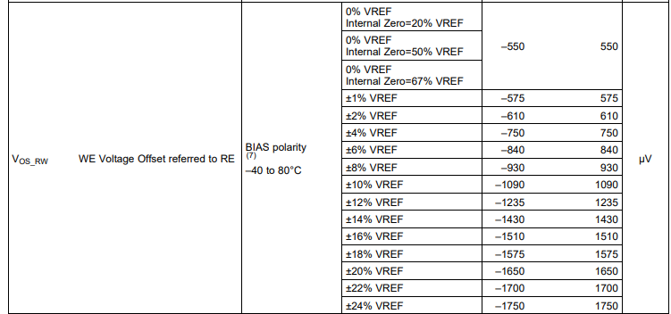

  • Robin,
    You are correct, the gain number is for the internal resistor. I misspoke, there is a min & max offset depending on the step of your bias voltage which is what the datasheet spec shows.
    Can you provide the Vref you are using as well as the output voltages you measure at the Vout pin?
    Have you measured all of the expected values (i.e precision resistors, current through R3) and used the measured values in calculations to be sure?
    I believe you could be seeing the sum of different errors such as any variation in the biasing levels along with the offset errors of the amplifier itself.

    I believe there could be two sources of the error you see.
    1) There is a resistor ladder internally that is not trimmed, so I believe that could be contributing the increased error you see as you lower bias steps.
    2) I also believe that you are driving the TIA negative rail too close to GND. If you increase the Internal Zero, you'd allow for my headroom here.
    For these reasons, I;d like to see if adjusting the internal zero gives you a little more linearity.

    As far as the specs you are concerned about, the TIA gain accuracy is 5%, but this is a typical spec. There is no min or max limit mentioned in the EC table, so it could be possible that your configurations would result in higher error.
    Jalen
