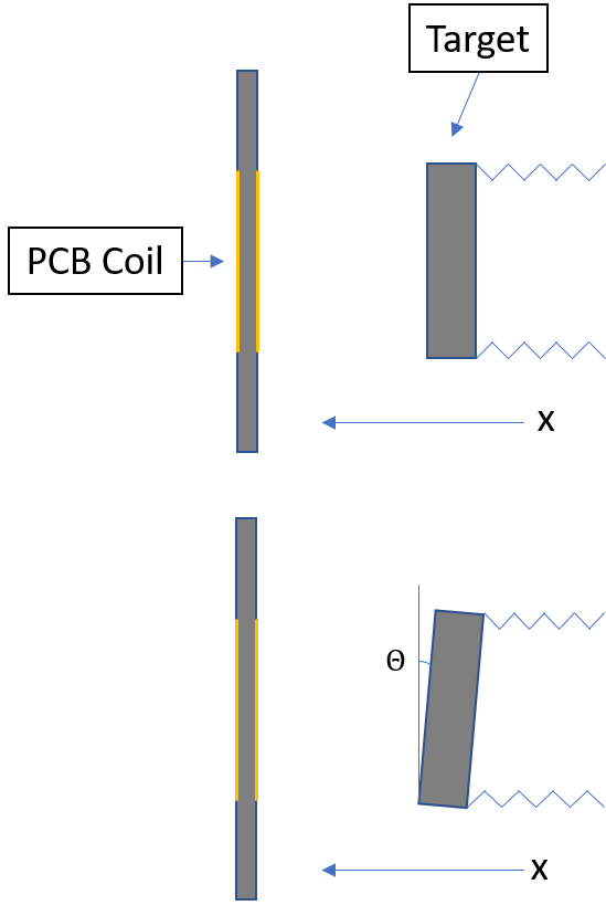

Does anyone have any information regarding the effect of non-parallelism on the inductance measurement of the LDC1101? I have a target that displaces axially in front of the PCB inductor coil. This target is also able to tilt relative to the axis of translation. Is there a way to quantify the effect of this tilt angle on the sensor measurement? I'd appreciate any information.
Best regards
Alex M.
  • Alex,
    Tilting of the target will impact the measurement. To quantify, you would need to collect test data. Note that a tilt will likely be indistinguishable from a change in distance of the target from the sensor.
    There might be a way to use multiple sensors to help compensate for this problem, but I cannot comment more without understanding what you are trying to do mechanically.
  • We're using the sensor coil to measure the position of an expanding and retracting bellows with an aluminum cap. Because the bellows is flexible there is a chance that it can tilt.
  • Thanks for the drawing. You could try using two side-by-side coils to help with this issue. That way, when you see a difference between the coils, you will know that there is a tilt.
    Unfortunately, this has a major drawback. The distance detection and resolution is always improved when a larger coil is used. By cutting the coil area in half, the maximum distance that the coils can detect will also be cut in half.
    Without using a second coil, you will find that a tilt looks identical to a small shift in the x direction. The success of the design will then depend on the tolerances that you are aiming for and the degree of tilt that is possible.
  • Sounds good. We'll just have to quantify then the effect of tilt on our measurement then and specify a tolerance on the maximum amount of tilt allowed. Thank you for your help. I appreciate it!
