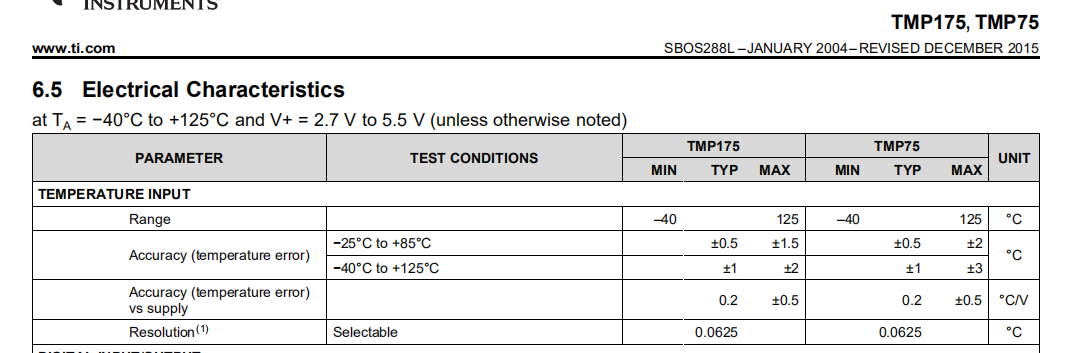

      I would like to ask you a question. We applied for two TI temperature sensors, TPM75A and 75C. I tested it. Find a problem.
TMP75C I read the temperature more accurately, and TMP75A read the temperature, can only be accurate to 0.5 degrees Celsius decimal part can only be 0 or 5,
The accuracy of the two manuals is 0.0625 C. I read both in exactly the same way through I2C.  Does the accuracy of 75A only reach 0.5 Celsius?
