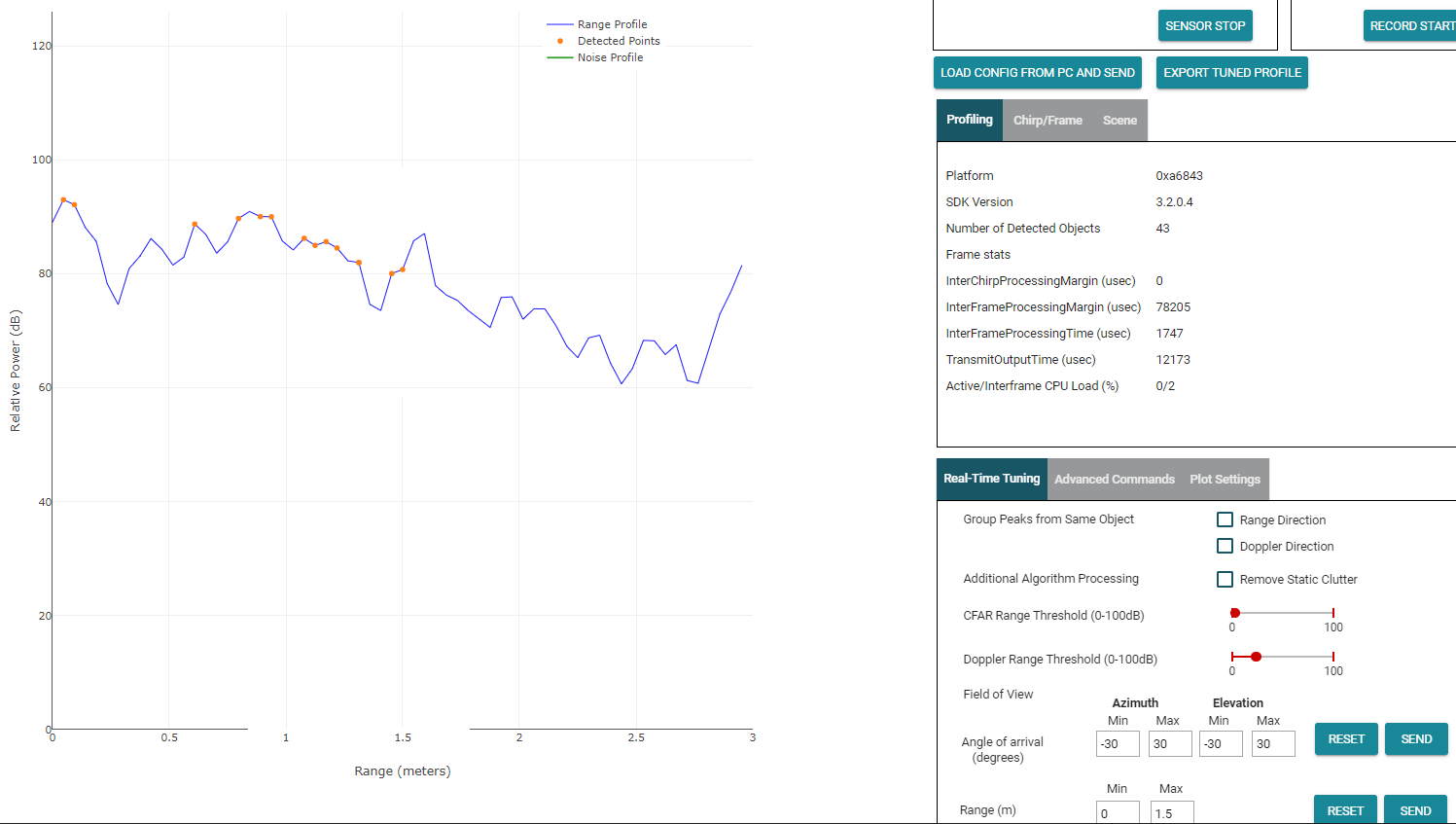

    We'll need more information in order to assist you. Would you be able to post both your x-y plot and range profile? A picture of your scene might also be helpful because it is difficult to discern what is truly going on here.
    Can you confirm you have static clutter removal turned off?

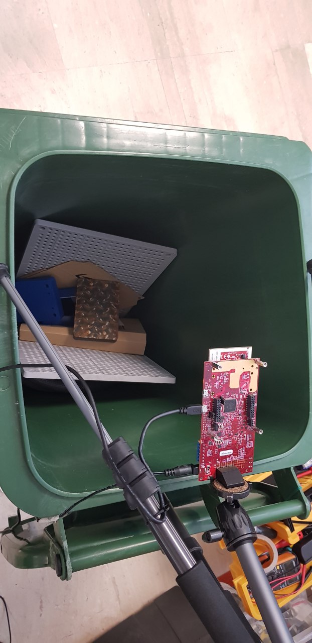

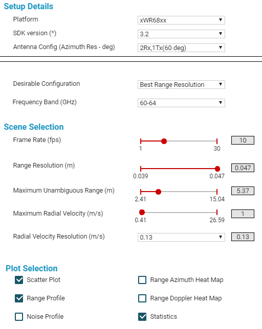

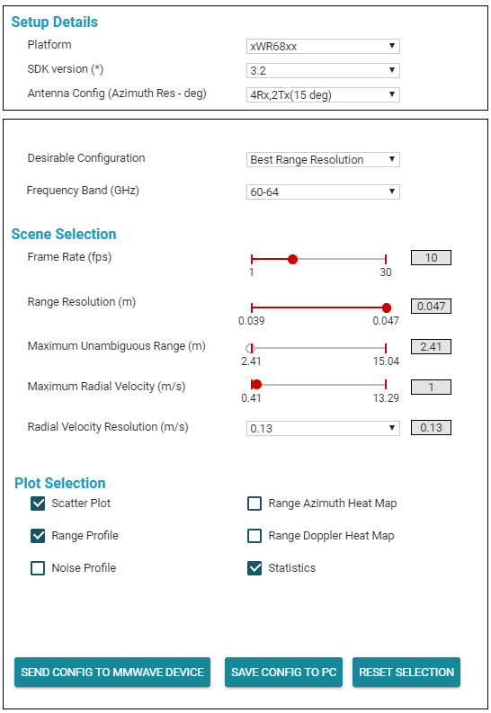

    Attached are the configuration and scene I have here.
    I'm testing with different antenna configuration, for our application the best option should be 60 degrees, but I got too much noise.
    In order to locate as much as possible I reduce the threshold but this didn't improved the measurements. The first element (gray plastic) is about 47 cm away from the sensor and the metal part is about 66 cm away. The distance from the sensor to the floor is about 1 meter.

  • Hi Daniel,
    I would recommend turning off the static clutter removal in your profile Chirp Configuration. You will want to change the second term of the clutterRemoval parameters to a 0, which indicates that static clutter removal has been disabled.
