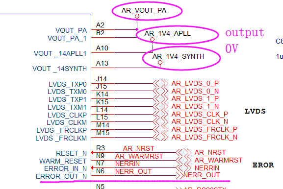

       I have meet  the same promblem  almostly ,
    After the power was established and ERROR_OUT triggered( ERROR_OUT  Pin N6 get to 0V);
      I  check My PCB, there is no any shorts, and the Power consumption is 5V , 0.25A;
      I check the clock by the oscilloscope , which is 40MHz ;
      The Reset is OK,too
      The voltages on the  IWR1642  , such as 3.3V , 1.8V , 1.2V , RF 1.3V ,are correct;
    but I find the voltages  VOUT_14APLL = 0V,  and  VOUT_14SYNTH =0V, VOUT_PA = 0V,   are   wrong ;
         and the ERROR_OUT triggered

    Can you share the full schematic? if all the boards are failing its more likely that there is a fault in the design.

  • Hi, Charles O,
        I have solved the problem;
       The SOP0 and SOP1  are charged  10ms From another  MCU  IO   when powered-on;
       thanks!
