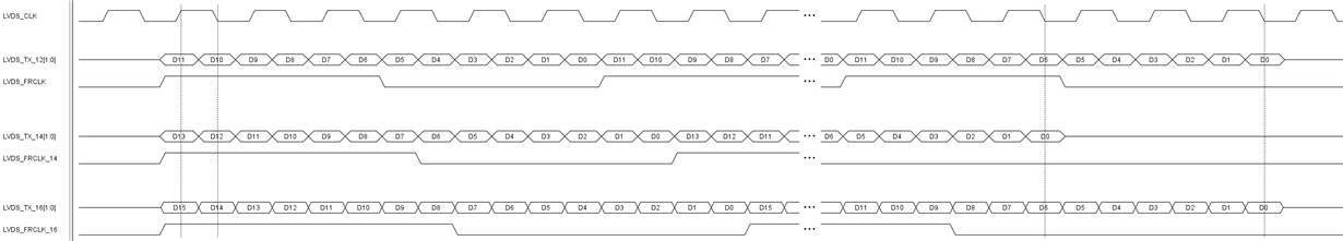

    Since the alignment of the signals in the timing diagram of the LVDS lines (e.g. in the Datasheet for the awr1843) is not optimal and the stopping of the frame clock is probably a bit misleading, I created them according to your information by my own for the three different bit-configuration cases. Is the image shown below correct (for the MSB first configuration)?

    The timing diagram you show above is correct, and you are right that 1642 and 1843 would have the same LVDS timing.
    Regarding your question about the 12/14/16 bit modes, for the ADC data in 12/14 bit mode internally we shift the 16 bit data to get only 12/14 valid bits. Its like LSBs are  truncated.  For CQ data is you select 12/14 bit modes , this impacts only the data transfer out on the LVDS interface and not really the valid data size. So if you had 192 bits of CQ data for example, in a 16 bit mode it would sent out as 12 samples (across 2 lanes) while in 12 bit mode it will be sent out as 16 samples (across 2 lanes). Each sample being defined by a LVDS FRM CLK  cycle. Does that help?
