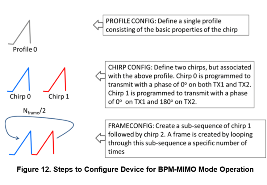

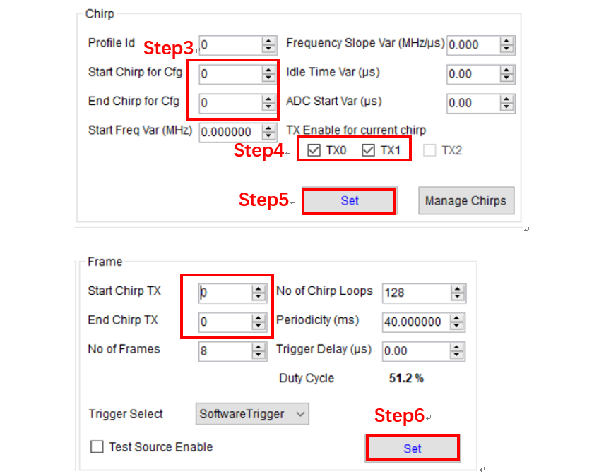

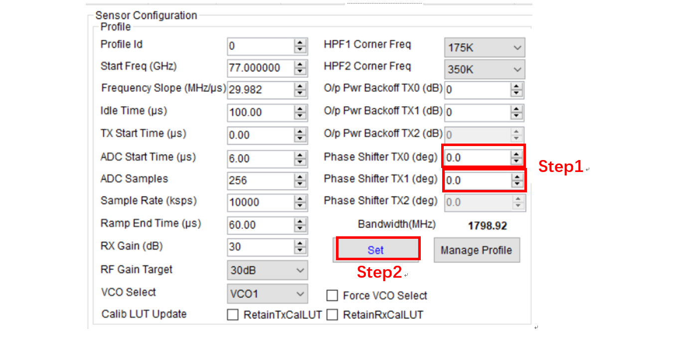

configure chirp0
configure chirp1

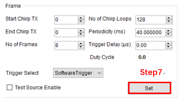

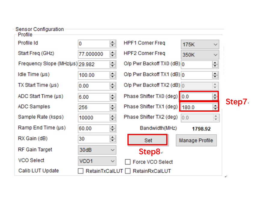

1、I want to know if my process is correct and how to Separate the waveform signals from two transmitting antenna?
2、How to configure CDMA?
  • The process above is about configuring BPM(DDMA)

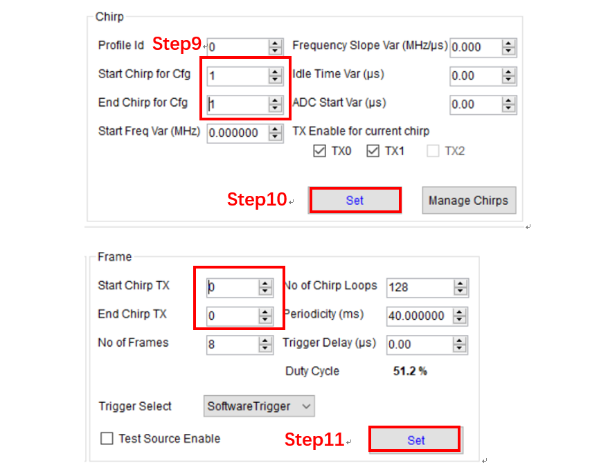

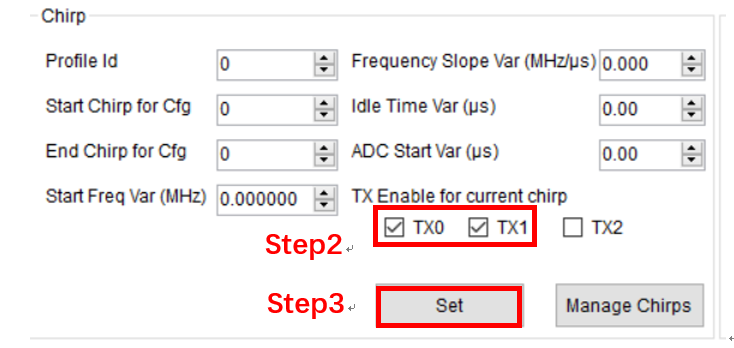

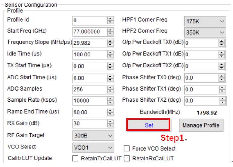

    To implement the configuration in Figure 12 above, you would do the following:
    1) Step 1 to 5 as in your figures above
    2) In Step 7, change profile to Profile 1. Then Step 8.
    3) In Step 9, change profile to Profile 1.
    4) In Step 11, change End Chirp to 1.
    Note that you should not do Step 6.
    Anand

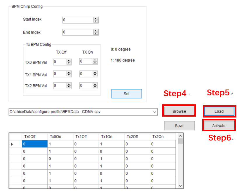

  • Hi Wang,
    For the second part:
    The CSV feature in the BPM chirp config tab (Step 4, 5, 6 in your figure above) is not working in this version; it will be fixed in a later version of mmWave Studio.
    For now, you will need to program it using the "Start Index, End Index" and "TX Off, TX On" part of the tab explicitly and press the Set button.
    I will get back to you on your first question regarding CDMA.
    Anand
  • Hi Anand ,
    1、which mmwaveStudio version will surport "BPM chirp config tab" ?
    2、does TI has some LUA script to set BPM chirp configration instead of pressing the Set button multiple times ?
    Simon
  • Hi Simon,
    1. This will very likely be included in the next release of mmWave Studio (2.1).
    2. I'm afraid we do not currently have any reference scripts for configuring BPM, but you can easily create your own lua scripts to set the BPM configuration. One way is to copy the command from the Output window into a text editor and duplicate it as many times as you have different BPM configurations and modify the fields as needed.
