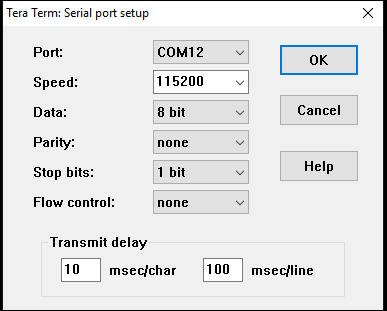

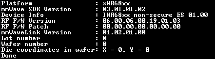

2. Please reboot the board in functional mode using the settings described above and connect a terminal program (e.g. teraterm) to the XDS110 Class Application/User UART port using the following settings. Then type the version command (do not connect the mmWaveDemoVisualizer):
mmWave COM ports shown in Windows Device Manager
TeraTerm settings
Version command output

Hi - USB was very intermittent, i got Terra term functional, and eventually after lots of power cycling, plunging in and out the USB cable I managed re-flashed the board with the latest rev - it now works fine.
This is issue is now closed - thanks
