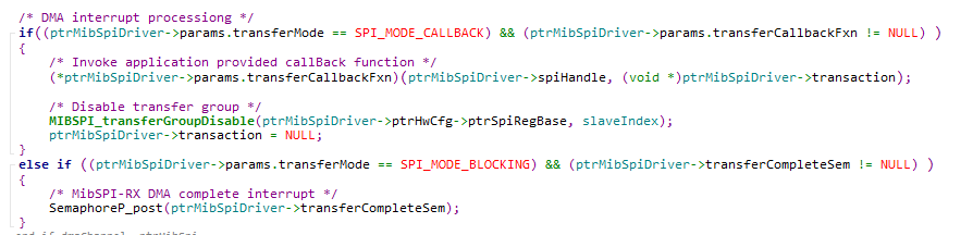

    Customer saw in the SDK that the callback was called.
  • Hi Annie,
    Callback will get called whenever 'MIBSPI_sysDmaIntHandler' get called. I tried SDK 3.2 SPI test application and in that it is able to hit this interrupt handler.
    So I would request you to check the SPI test application to verify if DMA interrupt handler is getting called.
