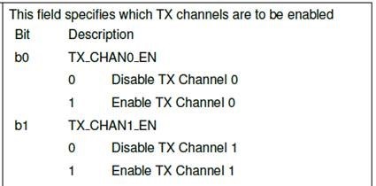

In AWR1642 continuous mode, we can select several kinds of TX/RX Channel combination.
From TI docs, I find the settings as below.
TX channel can be selected by 0/1/2/3. RX channel can be selected by 0-15.

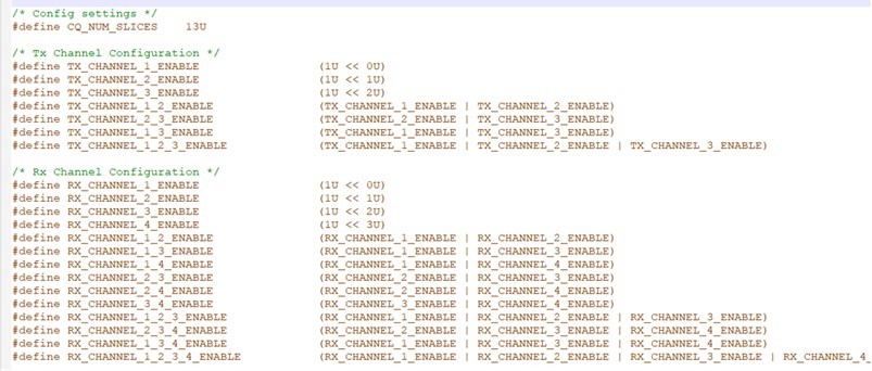

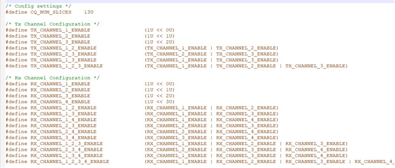

From SW code example, I noticed that you only define Macro as below.
0 is not a selection for TX/RX channel.

    MACRO are given here to enable Tx/Rx. If you need to disable any Tx then don't set that bit in the parameter while invoking rlSetChannelCOnfig API.
    Each of Tx can be disable/enable individually using the above said API, set/reset the specific BIT [rlChanCfg_t->txChannelEn].
    And for CW mode device will emit from all the Tx which are enabled from channelCOnfig API.
    So please try this experiment and rightly enable/disable Tx and then check for power difference.
