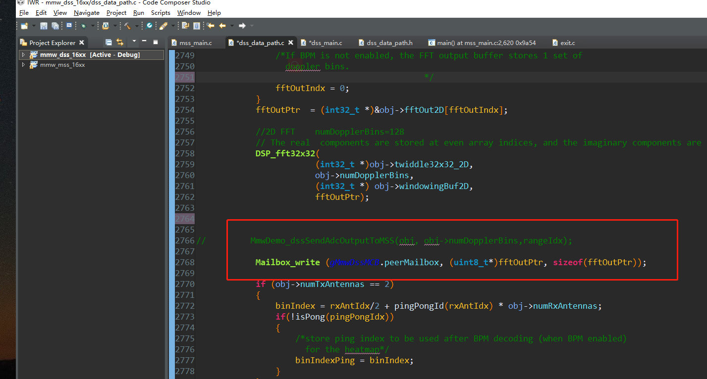

I tried to output 1642 2D FFT data from the serial port, but the serial port has no data output, and an error message is printed on the console. What is going on?

  • Hi Justin,
    I am using the IWR1642BOOST DEMO board.
    The screenshot below is part of my code change.

  • Hi ZHG,
    It looks like the mailbox does not recognize the message, so the software is not reaching the UART_writePolling line. You need to set the type of message.  You can see from the error code that the message type is not set when the message is sent - as a result, the message id is different in each version of the error.  Ensure you set message.type, and ensure that the mss has a condition to read that type.

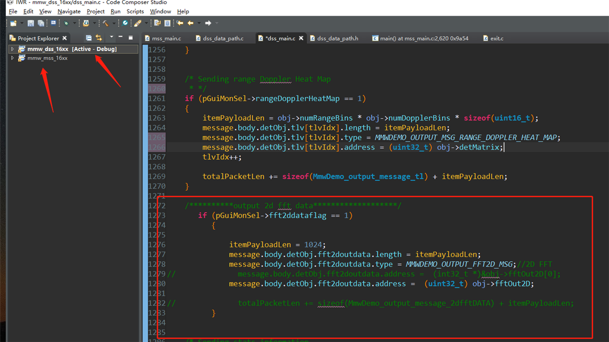

  • Hi Justin,
    I have set the message type.There is still some code that I have not shown, and now I am not sure if I have read the message type. I don't know how to do this. Is there any good advice? Thank you.

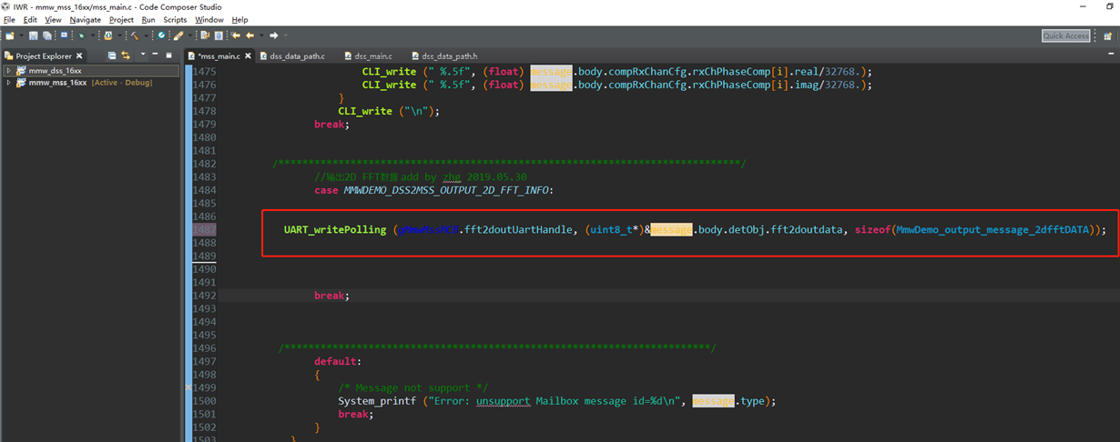

  • Hi ZHG,
    So there is a file that defines the message types.  This is stored in common, but after importing to CCS, this file is actually duplicated.  So you will need to make sure the message type is defined in both versions of the file.
    When the MSS reads the message, it first reads the type, then does some action based on that message type. First thing to check is to make sure that the message type is the same in each frame to ensure that you are setting the type properly. (This is displayed when it outputs unidentified message type: xxx)  If the message type is the same every frame, you are setting it properly.  Then you just have to make sure that:
    1. The type is defined in the .h file. (Click on a different message type and press F3 to be taken to the file in question)
    2. Ensure there is a case for that message type defined in the mbox task.
