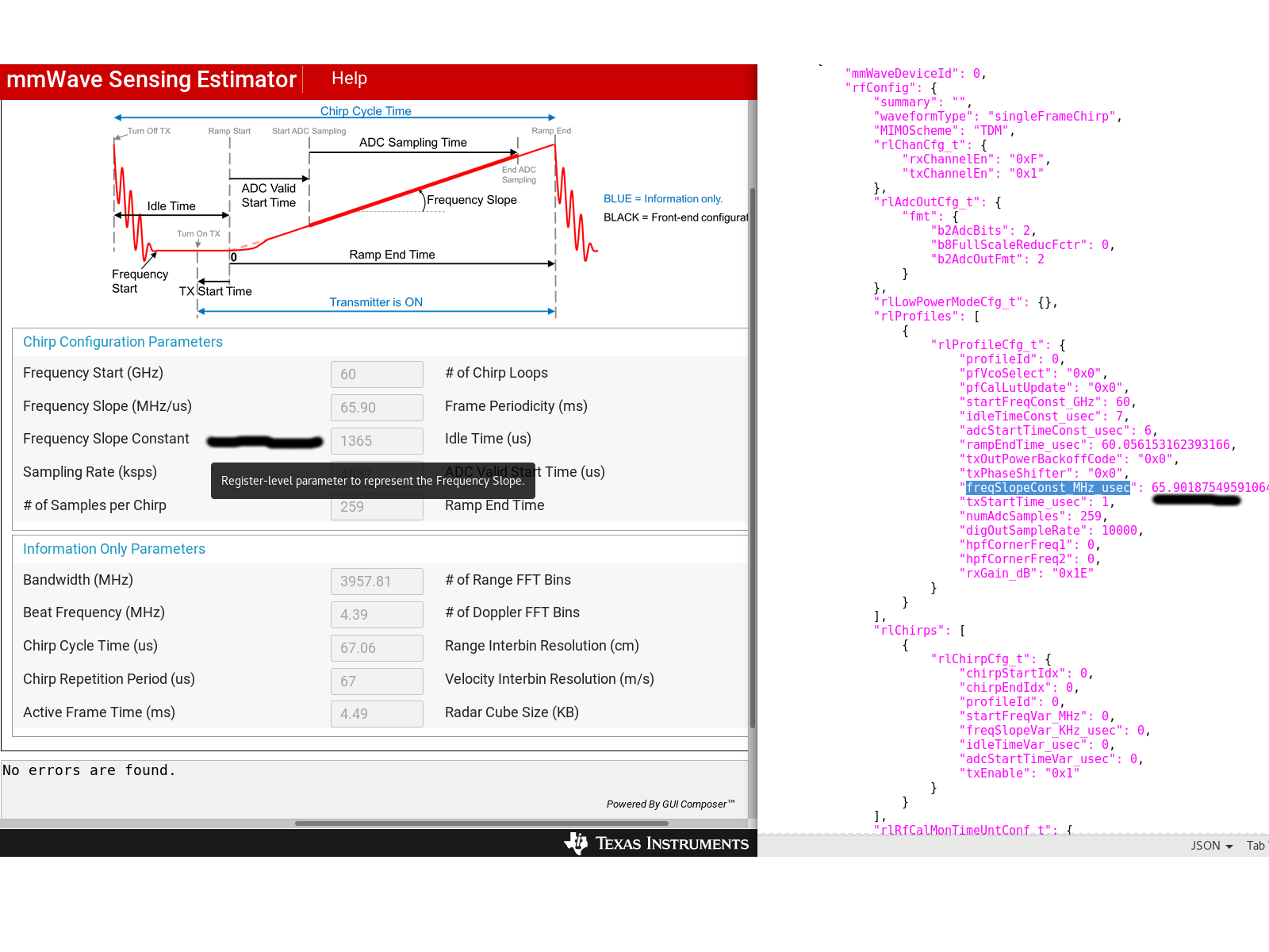

I am trying to run the  IWR6843 using only Tx1.

The config file I am using is seen below. I have a firmware running that is working fine with other config files using Tx1 + Tx3, using the last config file below.
I must have made some mistake when moving to using only Tx1, but I can not spot it. Are there any examples of configurations using only one Tx?
My goal is to chirp over a bandwidth of 4000GHz (as much of it as possible) using Tx1 (first Tx).
I have used mmWave Sensing Estimator https://dev.ti.com/gallery/view/1792614/mmWaveSensingEstimator/ver/1.3.0/
to get the current single Tx configuration file.
Grateful for any input.

  • Correction:
    It looks like the mmWave Sensing Estimator tool showed some values in the GUI but when exporting the file, other values were shown.
    I will test these other values.

    The IWR6843 device only supports up to 8Ghz chirp bandwidth. Looking at the 1TX chirp configuration you provided it looks like you are trying a profile that spans greater than 8GHz.
    This is not supported and will give an error.
    Amanda
  • Hi
    Thanks for your input.
    Looking at the IWR6843 info page, it looks to me like the IWR6843 only suppors 4GHz continuous bandwidth in the range 60-64GHz, I never intended to exceed that, but to cover as much as possible of it. I fail to see how  my configuration exceeds this, see my calculation below.
    When I check my configurations I get my bandwidth that I try to use to 3957.69699 MHz starting at 60GHz (rampEndTime * freqSlopeConst, 60.0561×65.90MHz/us = 3957.69699 MHz bandwidth), keeping me in the range [ 60 - 63,95769699GHz ]
    But I might lack some understanding, I will double check my configuration.
  • Problem solved.
    As I can understand it I had some problems with the ADC sample rate and number of ADC samples.
    I still use about the same bandwidth according to me: (rampEndTime * slopeConstant = 74 * 53.3 = 3944.2MHz bandwidth).

    Your bandwidth calculation is correct. I was referring to the first chirp configuration where your slope was 1395 - I now see that you updated it to a lower slope constant which is within the bandwidth.
    I will report back the bug you found in the sensing estimator where the GUI is different from the exported file.
