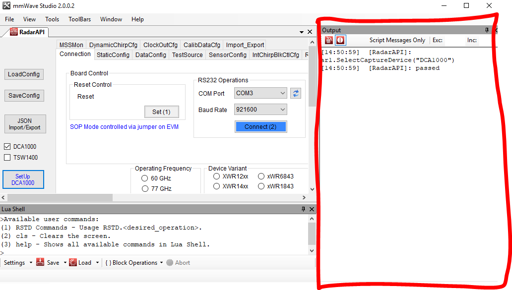

I am using a IWR1642 with a DCA1000 board to collect RAW data from the device with mmwave-studio. I usually collect data for about 30 mins using the script below in one session. But mmwave-studio keeps crashing randomly. Sometimes I go through 30 mins without a crash and sometimes the tool crashes within 10mins. I am using the matlab engine linked in the quick start guide for the DCA1000 board and also have the required versions of Microsoft visual C++. I tried using 4 different computers, 2 different pairs of IWR1642 and DCA1000 boards. I also tried using a AWR1443 with a DCA1000 board. The tool still keeps crashing. All my computers were running 64 bit Windows 10 OS. I checked the logs from mmwave studio and the logs always stop abruptly. There are no error messages or any indication of an issue in the logs. Anyone else have the same issue? and is there a fix for this?

  • Hi Kalvik,
    Are you using matlab runtime engine 8.5.1? Please try running your same configuration through mmWave studio without matlab and let me know if this works. Please also send me any error messages that pop-up.
    -Chloe
  • Chloe,
    Yes, I am using Matlab runtime engine 8.5.1. I got it from the link provided in the DCA1000 board's quick start guide document. Also the script I am using to collect my data is a lua script. I am running it from mmwave-studio. I am not running anything directly from matlab. I am getting no error messages. The GUI just crashes and the logs just cutoff at the last command it ran without any error messages.
  • Hi Kalvik,
    Can you please try reducing the data rate and let me know if you still have the same issue?
    Chloe
  • Chloe,
    What do you mean by data rate? Can you please be a  bit more specific? Do you mean the Sample Rate or Chirps Loops or Periodicity or something else?
  • Please reduce the sample rate.  Also, can you please recreate your setup in mmWave studio without a lua script and see if you are still getting the same issue?
    -Chloe
  • Chloe,
    I reduced the sample rate to 4800 from 5000. And the GUi still crashes. I can't reduce it any more without changing a few other parameters. Is there a specific config you would like me to test?
    Are you wanting continuous chirps?  Please try the config listed in the thread below.
    https://e2e.ti.com/support/sensors/f/1023/t/756591?tisearch=e2e-quicksearch&keymatch=continuous%20chirps
    -Chloe
  • I am trying to collect 100 separate samples each lasting 6 seconds with the profile config for the IWR1642 board in my script. I don't want to collect the data continuously. I tried a few different chirp configs just to see if the tool crashes and it does.
  • Hi Kalvik,
    Please send me the output log with your configuration.
    -Chloe
  • I attached 4 logs files where the GUI crashes. As I mentioned before the logs just cutoff before the crash. And the crash doesn't seem to be happening at a particular operation either. You should be able to find the configuration setting outputs at the beginning of each log file. Log0211_0.txt
    GM: Constructor

  • Hi Kalvik,
    Can you please check the sizes for all the 'adc_data_Raw_0.bin' files for the different computers? You can find this in the mmWave studio folder \mmwave_studio_02_00_00_02\mmWaveStudio\PostProc
    Chloe
  • The adc_data_Raw_0.bin file is 185,770 KB and the adc_data.bin file is 184,000 KB on every one of my machines.
  • Hi Kalvik,
    I will look into what could be causing mmWave studio to crash when the .bin files reach this data size.
    Please follow along with this training video to ensure you are correctly following the steps for data capture with mmWave studio.
    https://training.ti.com/dca1000-training-video?cu=1128486
    -Chloe
  • Yup, I went through all 5 sections of the training video. As far as I know I followed all the steps as suggested.
  • Hi Kalvik,
    Have things started working for you?  I am still looking into why it may be crashing.
    -Chloe
  • Nah, I went through the training videos again and couldn't find any issues with my process. The tool still keeps crashing.
  • Hi Kalvik,
    Please read through this thread and follow the suggestions listed.
    https://e2e.ti.com/support/sensors/f/1023/p/768997/2867705?tisearch=e2e-sitesearch&keymatch=DCA1000EVM
    -Chloe
