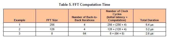

Radar Team,
The HWA user's guide SWRU526b, p.41, Table 5 gives FFT benchmarks for 8, 128, and 256 pt. FFTs. The HWA supports up to 1024 pt. FFT natively. Do we have the benchmark for 1024 pt. FFT?
Thank you,
David
