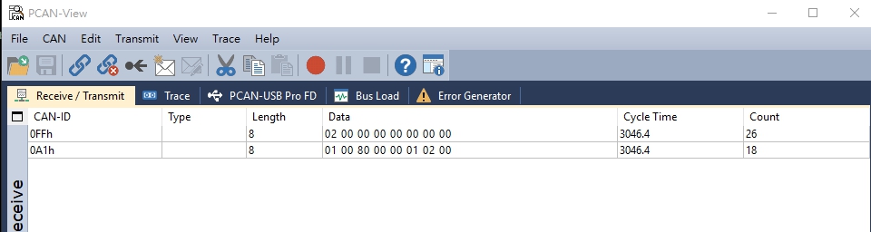

I have some crash problem about CAN transmit.

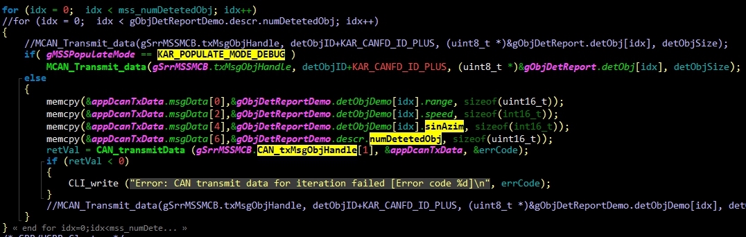

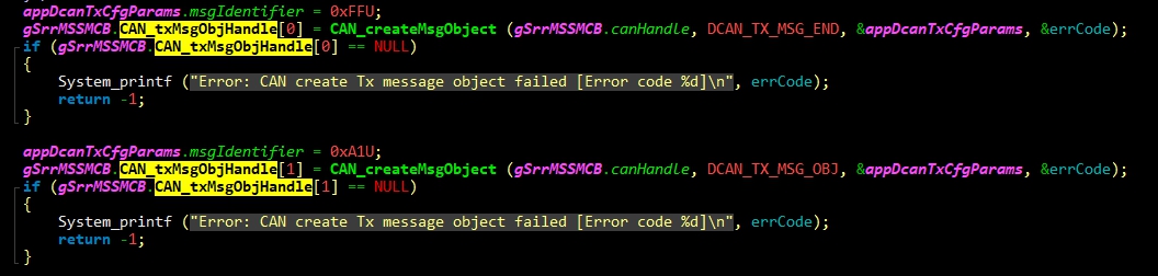

I want to transmit two 8byte data which ID is "0xFFU" and "0xA1U" and I design the code as below.

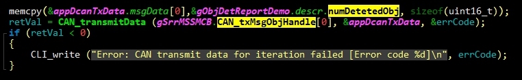

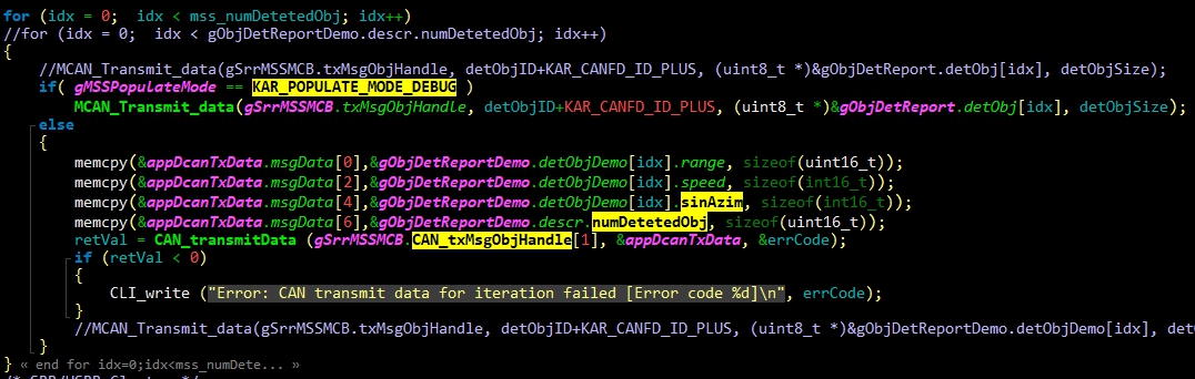

When I just transmit gSrrMSSMCB.CAN_txMsgObjHandle[0] it works ,but if I also transmit gSrrMSSMCB.CAN_txMsgObjHandle[1] it will crash .
I analysis package on the PCAN-View the cycle time is very huge (without transmit "gSrrMSSMCB.CAN_txMsgObjHandle[1]" ,the cycle time is about 60ms ,but "gSrrMSSMCB.CAN_txMsgObjHandle[1]" is just a 8byte package too)

    Here's the issue :
    When I use the "gSrrMSSMCB.CAN_txMsgObjHandle[1]", the cycle time will be very large and the RADAR keeps hanging on(show as the PCAN view that I just post),  no reply.
    Then it crashed.

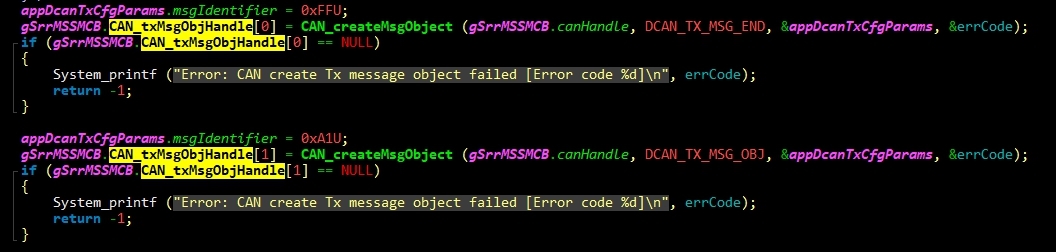

    Should I need to initialize DCAN or delete some data in txhandle before I change "gSrrMSSMCB.CAN_txMsgObjHandle[0]" to "gSrrMSSMCB.CAN_txMsgObjHandle[1]" ?
