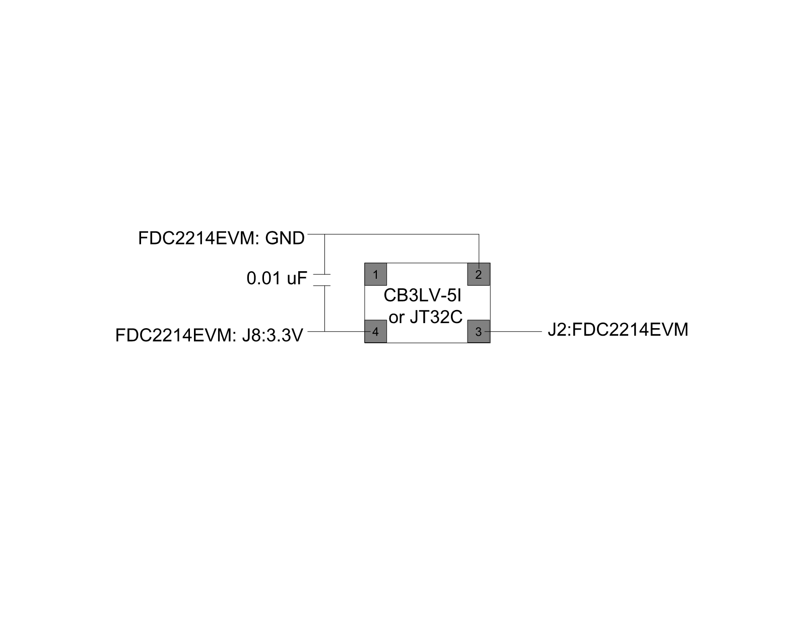

    Below is my connection illustration. Power supply (3.3V) and ground (GND) were taken from the FDC2214EVM, a 0.01 uF capacitor (10000pF ±5% 100V Ceramic Capacitor C0G) was added in between. The oscillator's output was connected to J2 on the FDC2214, J2 is originally designed for an external off-board oscillator.  Attached is an schematic of the FDC2214EVM. R22 was removed to disable the on-board oscillator 625L3C and R14 was added to enable the off-board oscillator.  The connections were made by soldering short (1-1.5") 24 AWG wires directly on the oscillator.

    The strange LED behavior could be because the external oscillator amplitude is too low for the FDC2214 to make reliable measurements. I'm not an expert with these oscillators, but your circuit looks correct to me. For now, I suggest disconnecting the oscillators from the EVM. Use an external power supply to power the oscillators and test their output with minimal output loading. If they are still not behaving properly, then you may need to contact the manufacturer.

    I used a power regulator,  LP2985AIM5-3.3/NOPB, http://www.ti.com/lit/ds/symlink/lp2985-n.pdf, and hooked it up using the same way as it's schematic of the FDC2214EVM, input power was taken the +5 V at the MSP430 section,  actual  input voltage was 5.15V for the off-board LP2985 and output voltage was 3.62V, I do not know why it's output was not 3.3V, however, the on-board LP2985 can produce 3.3V(actually 3.27V).
    I got the off-board Oscillator supply current (2.05 mA)  and output voltage (1.67V), which was  slightly higher than it was using the on-board 3.3V power source, probably due to the higher input voltage 3.62V than the 3.27V, however, it is still far below its spec values.
    It is difficulty to understand that both manufactures oscillators behaved the same way. I already contacted the two manufacturers on last Friday and am waiting for their replies.
