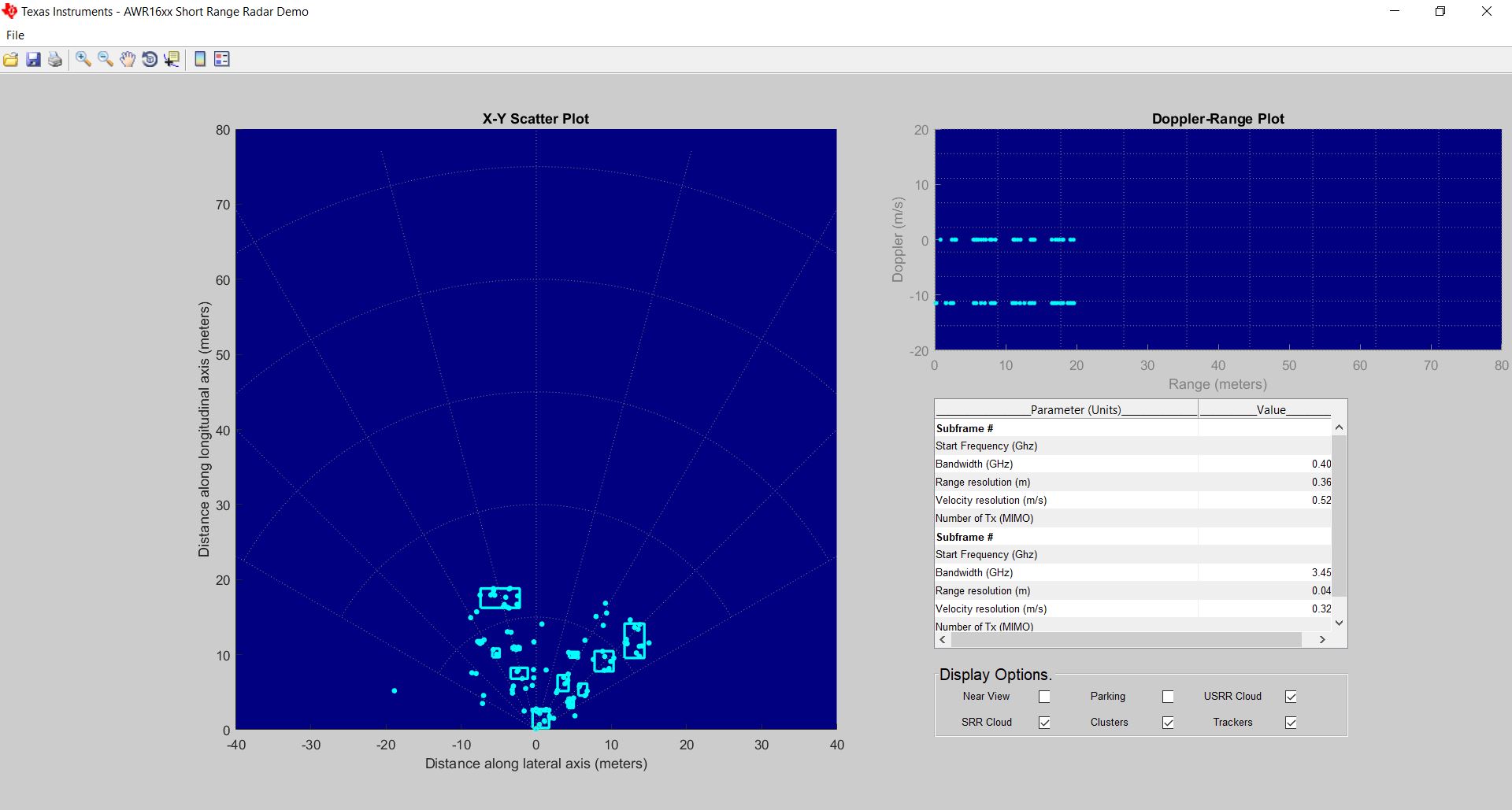

Hi
I’m trying to work with SRR demo using awr1642boost-ods. The board is in a room which all of the objects are static, but as u can see in Doppler-Range plot it shows that there are obstacles with approximately -11m/s velocity. The configuration is set for USRR (one subframe) which has the maximum range of 20 meters and maximum velocity of 5m/s (18km/h) so it shouldn’t show -11m/s in any scenario. Can anybody please help me with this?
