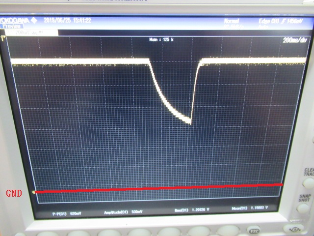

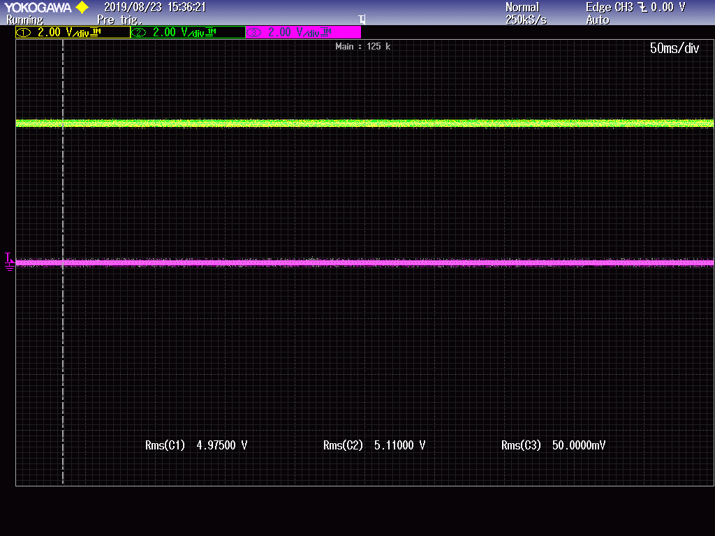

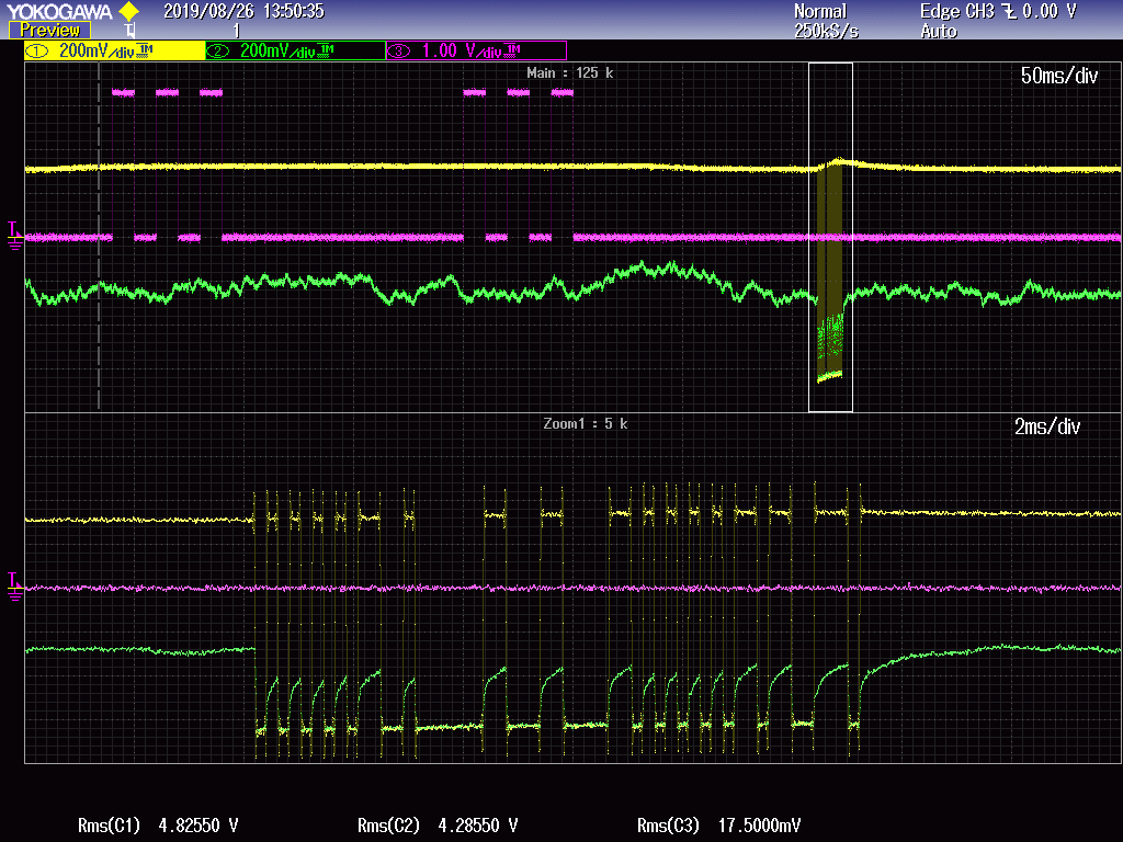

I am studying about PGA 300 and PGA 900. When I use PGA900 there is no problem, but when I use PGA300 OWI can't active in PGA300 GUI.

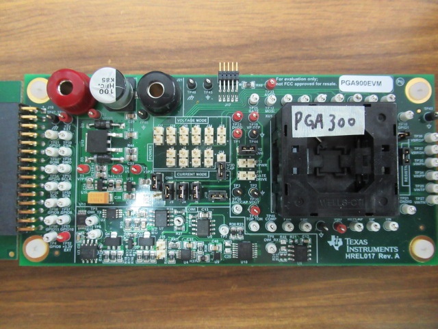

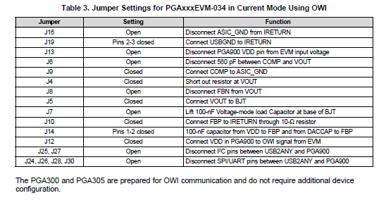

I use the evaluation board PGA900EVM, and I use the same evaluation board to evaluate the PGA300. The jumper setting is in the current mode (SLDU011, Table 3). OWI configuration is reset at each startup.
When I use the evaluation board PGA900EVM to evaluate the PGA300, are there any points to change other than the IC?
