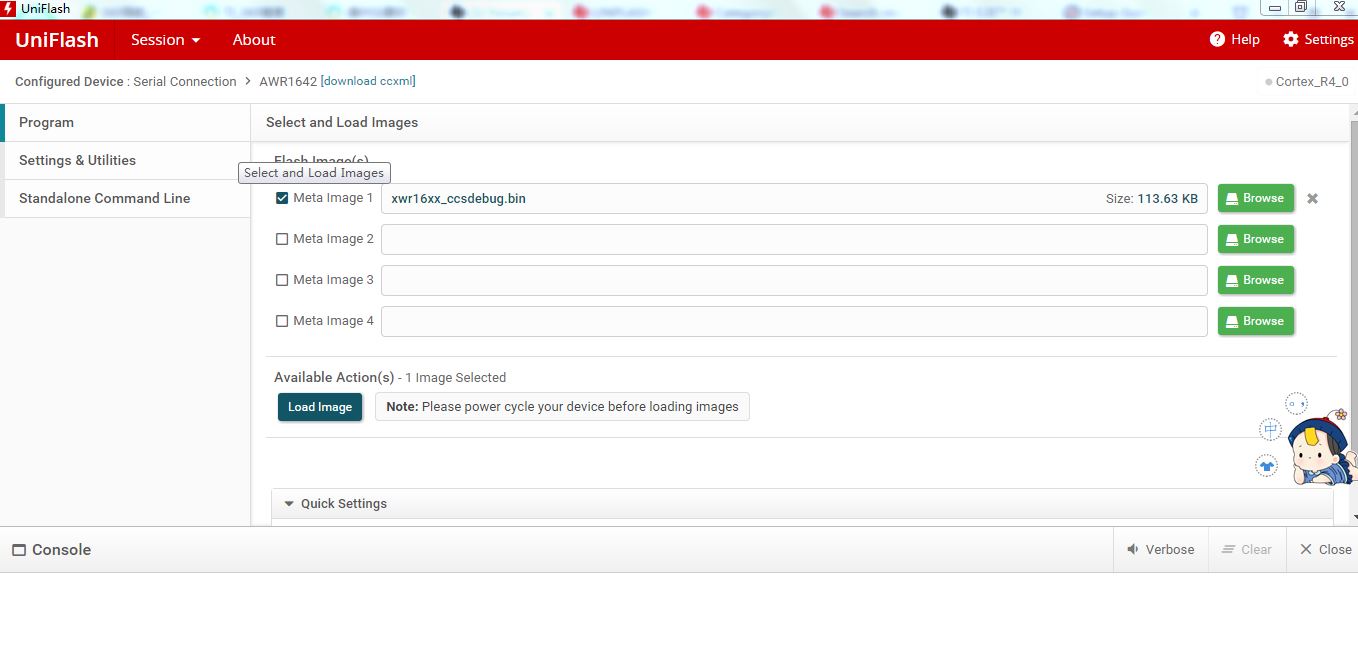

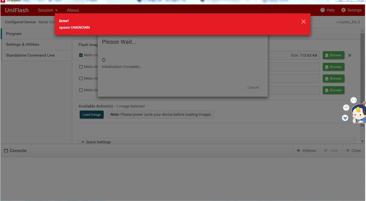

When I use uniflash to programme the IWR1642BOOST EVM ,some problems arise.When I click "load image",the screen shows ,"error:spawn unkown".How can I solve it ?

Hi User,
Would you be able to post a full screenshot of your Uniflash when this error occurs? Can you confirm you are following the flashing instructions in the SDK Demo User Guide?

Hi XU,
Do you have a different board you can try this with? Does any message appear in the console? Is any log file generated here?

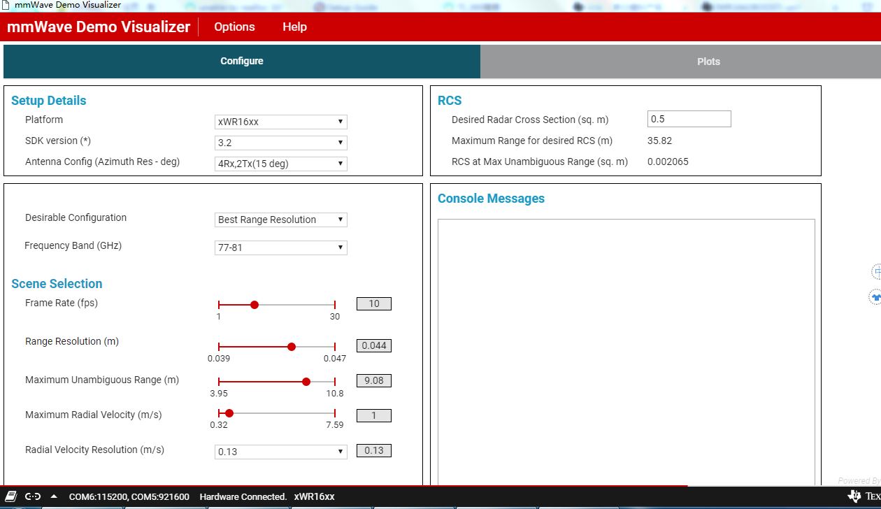

Hi Akash,
The version of my mmwave demo visualizer is 3.2.0, SDK is 2.0,and CCS is 8.3.1.Is there any problem with that?
Cheers,
XU
Hi XU,
The Visualizer version might be incorrect. Could you try on a the Visualizer Version 2.1?
You should also make sure that no other UART terminals are connected (TeraTerm/Putty or even Uniflash)
