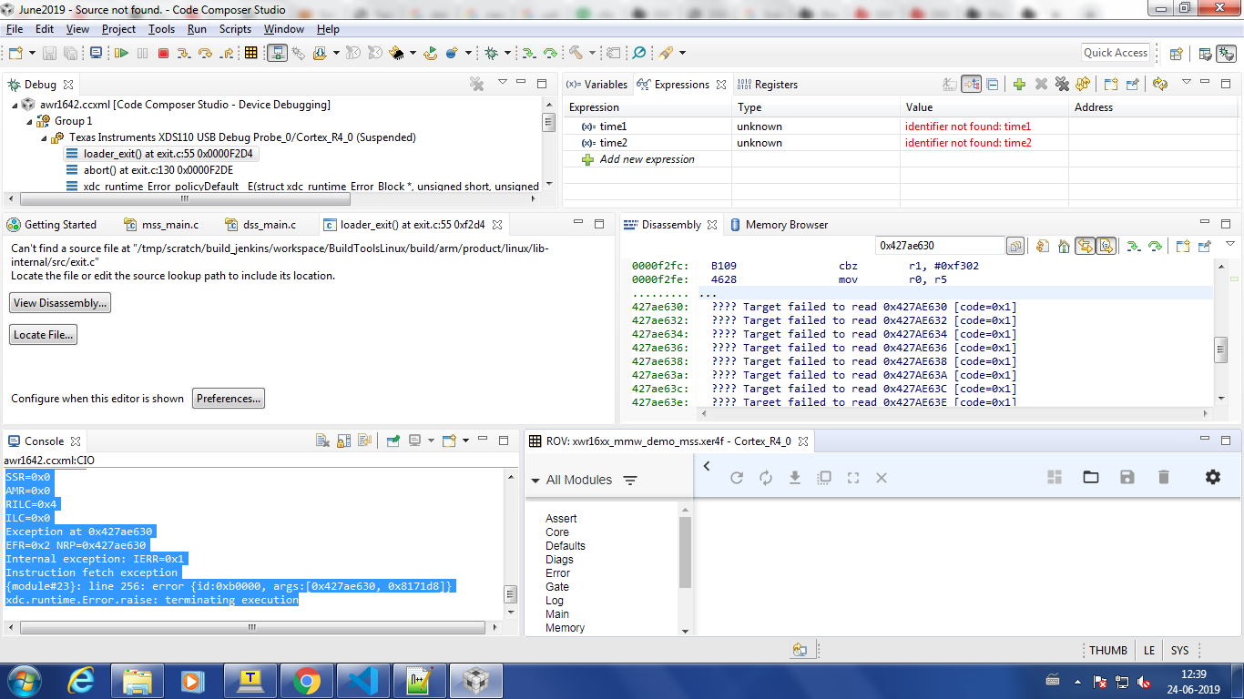

I am trying to do floating Point FFT on AWR1642ODS. But i am getting Instruction Fetch Exception.
I am suspecting some parts of memory may be getting corrupted but i can not find any way to find what is getting corrupted.

Exception at 0x427ae630
EFR=0x2 NRP=0x427ae630
Internal exception: IERR=0x1
Instruction fetch exception
{module#23}: line 256: error {id:0xb0000, args:[0x427ae630, 0x8171d8]}
xdc.runtime.Error.raise: terminating execution

  • Hi Anurag,
    If you are trying to add some code which impacts any of DSP memories (L1/L2/L3) then make sure to calculate it properly and allocate accordingly.

    Thank you for quick response. Actually I am saving output data in L3.
    Modified code in dss_data_path.c file below.
    /*! L3 RAM buffer */
    #pragma DATA_SECTION(gMmwL3, ".l3data");
    #pragma DATA_ALIGN(gMmwL3, 8);
    uint8_t gMmwL3[ODSDEMO_L3_SIZE-10000];
    #pragma DATA_SECTION(ptr_fftStore, ".l3data");
    #pragma DATA_ALIGN(ptr_fftStore, 8);
    float ptr_fftStore[64*64];
    I need to call FFT library 469 times in one frame interval. will it be feasible to call that many time?

  • Hi Anurag,
    There can be multiple reasons for this error.
    1. If processing of one frame data overlaps next frame window.
    2. Processing and sending object data over UART must complete within that frame only, else DSS will hit an ASSERT.
    3. Calling multiple times FFT library may cause stack overflow or other allocated memory overflow (L1/2/3) and might adding more processing time to slide over next frame duration.
    I would request you to check these cause.
