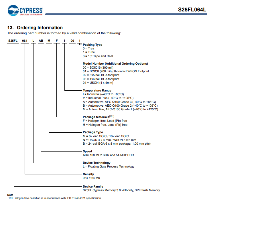

My customer would like to confirm the validated and supported Cypress QSPI Flash parts for IWR family. Please take a look at 1.4 Flash Variants in the following document:
Here, S25FL064LVF01 is supported for xWR1642 ES2.0, xWR1842 ES1.0, xWR1443 ES3.0 and IWR6843 ES1.0. But actually, I could not find the related part in Cypress datasheet:
Could you please clarify the exact part number ?
