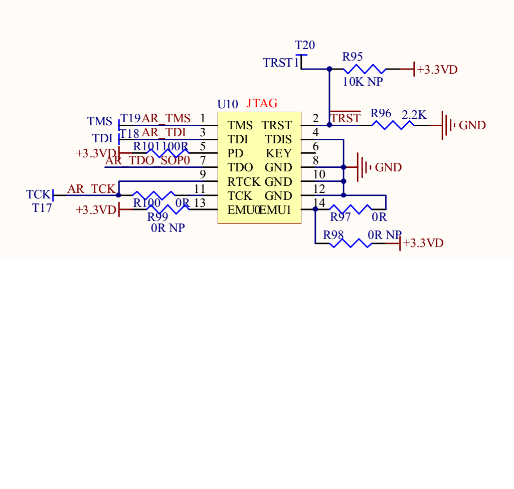

My customer ordered one Blackhawk XDS560V2 emulator, they want to know whether this emulator can get DSP trace from AWR1843?

Thanks for your reply. Could you also check whether Blackhawk USB 560v2 System trace also support AWR1843?
https://www.blackhawk-dsp.com/products/jtag-emulators/usb560v2
I checked it in Blackhawk page, but could not find AWR1843 support description. I don't have this emulator in my side, so I can't verify it.
Another question is customer is using TI 14-pin emulator, and do they need to loop out EMU0 and EMU1 pin to connect to 60-pin XDS560 v2 MIPI header?
Adam
Hello Adam,
For the emulator there would be no difference between 1642 and 1843, they have the same cores.
I don't think we support EMU pins.
Vivek
Hello Vivek,
Do we have an example on how to use R4F/C674x trace in AWR1642/1843? Does any customer already use it?
