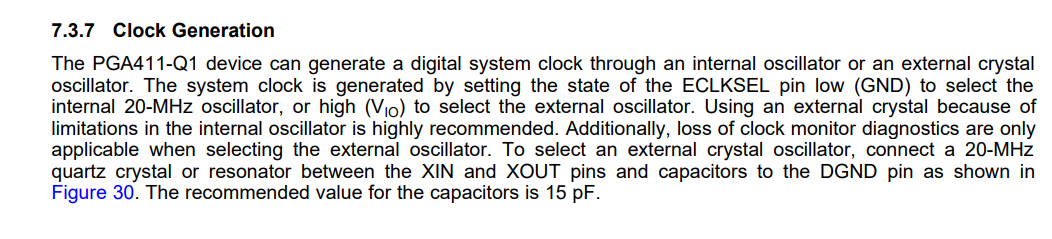

Part Number: PGA411-Q1
Can I use the external clock of lesse frequency? The reason being, I want to sample the 12-bit ORD outs in my system using external trigger(which would be ORDCLK) but since its too high (10MHz) so In the datasheet, TI has suggested for 20 MHz and in the EVM they have used 24MHz. am afraid it would sample properly.
