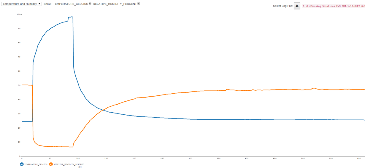

    The heater tops out at about 100C and the impact of it being on make the returned humidity level drop drastically. Here you can see a graph of HDC EVM operating at room temp/humidity and me turning the heater on, letting it rise up to 100C and then turning it off, to show the result of it then coming down in temp and humidity levels going back up.
    The difficult part about telling you specifics is your test or actual conditions might vary greatly from anything I could propose and if you did not have a control system, then all you could do was use the HDC device to do then is make an alert that condensation did occur - but as long as condensation was persistent, I am not sure if trying to use the heater at that point makes sense.
