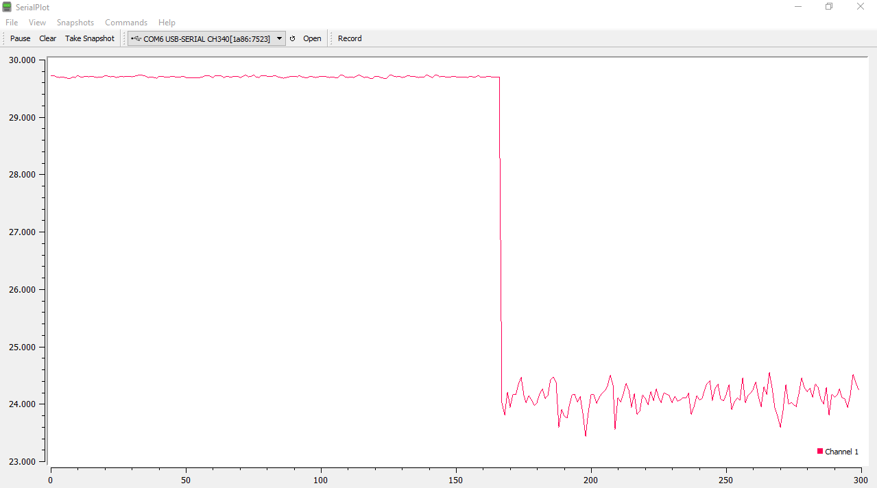

  • ok i tried set H0 to 0 and G0 to 1. I only recieved 0x00 on every byte. switching back to default values i got data again.
    by the way i compared a plot of PADC data (left) to a plot of "compensated" data (right). same bridge voltage, same amplifing (100x), same data reading, no load on loadcell, h0=0,5 g0=0,25.
    where does the high noise come from? TEMP_CTRL is set 0b00100011 but this schould have no effect because all coeffitients which are affected by temperature are 0.
    on OP_STAGE_CTRL there is 4_20MA_EN set by default is that correct?
    on DIG_IF_CTRL there is bit2 set by default but on datasheet it is marked as reserved, what does this affect?
